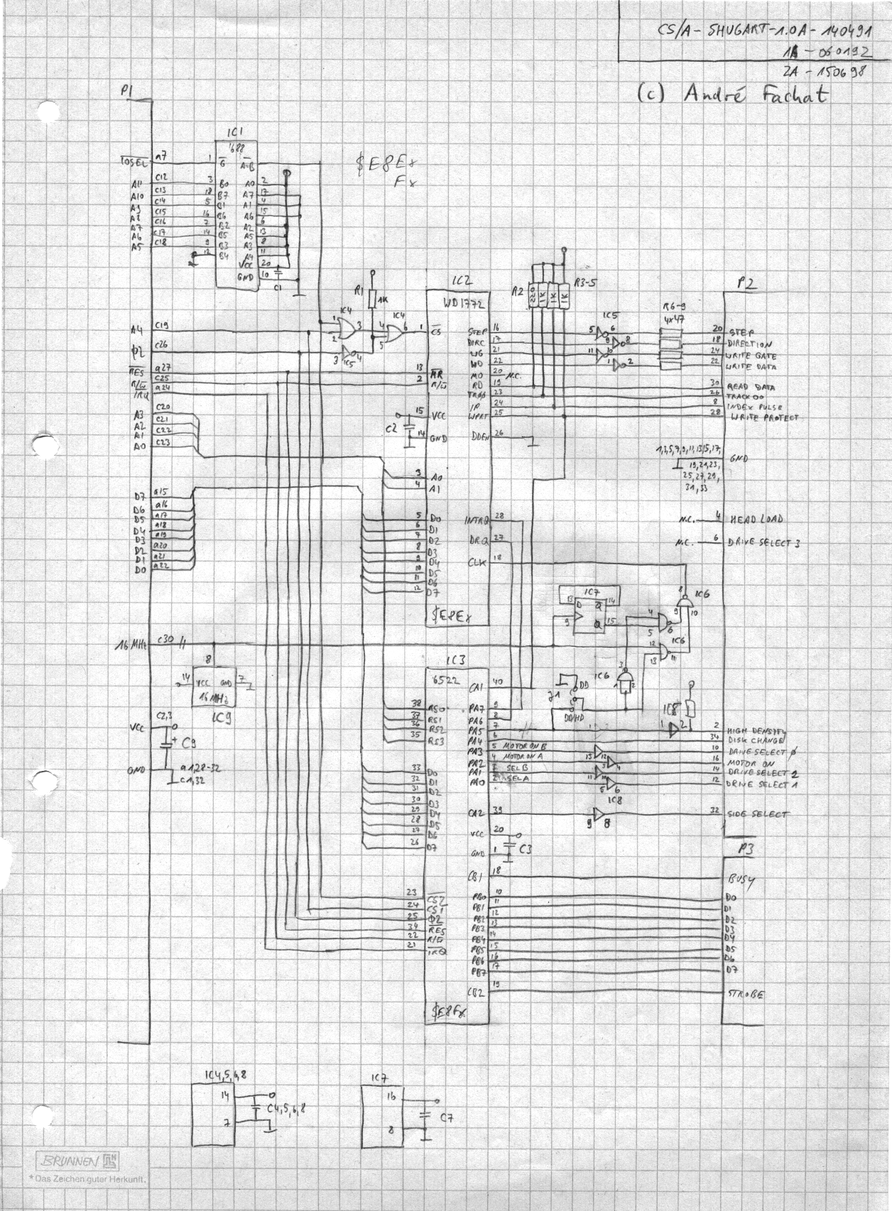

Notes
This board implements a (shugart-type i.e PC-type) floppy disk controller. The board has been tested with 5.25" and 3.5" PC disk drives.
I can't reconstruct what mandated the move to a 1.2 revision. The only difference I can currently see is the jumper to select if DD/HD is soft-switchable or not. What can also be seen is that the hand- and computer-drawn schematics were not always fully in sync (see the revision marks and the respective dates...)
Using this board with HD-drives (i.e. 1.44M 3.5" floppies overclocks the WDC1772 chip used in this board, as it is only specified for DD-disks (720k).
