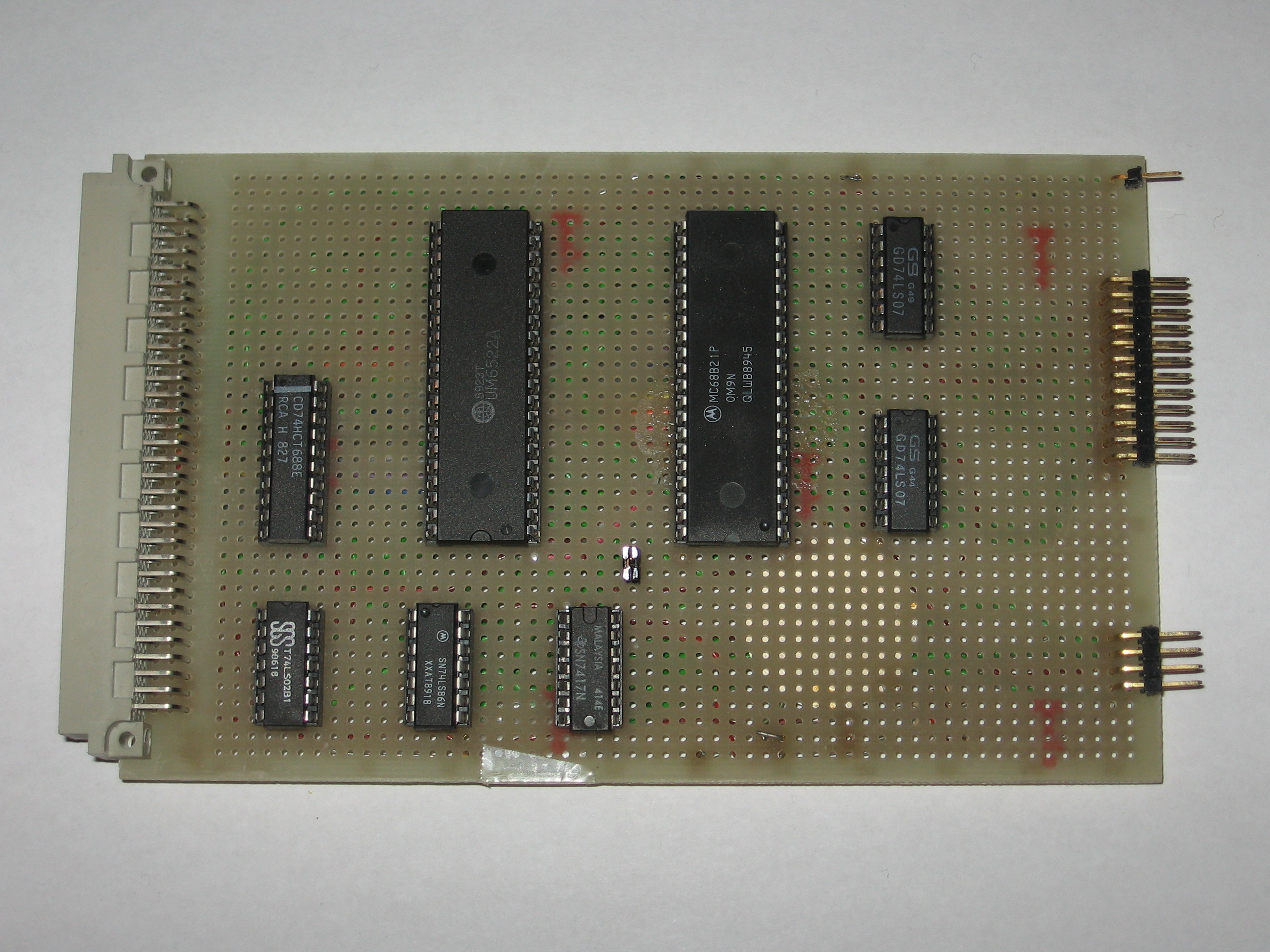

CS/A65 IEC
This board implements an IEEE488 interface, as well
as a Commodore serial IEC bus interface, as used in
the VIC20 and C64 (and others).

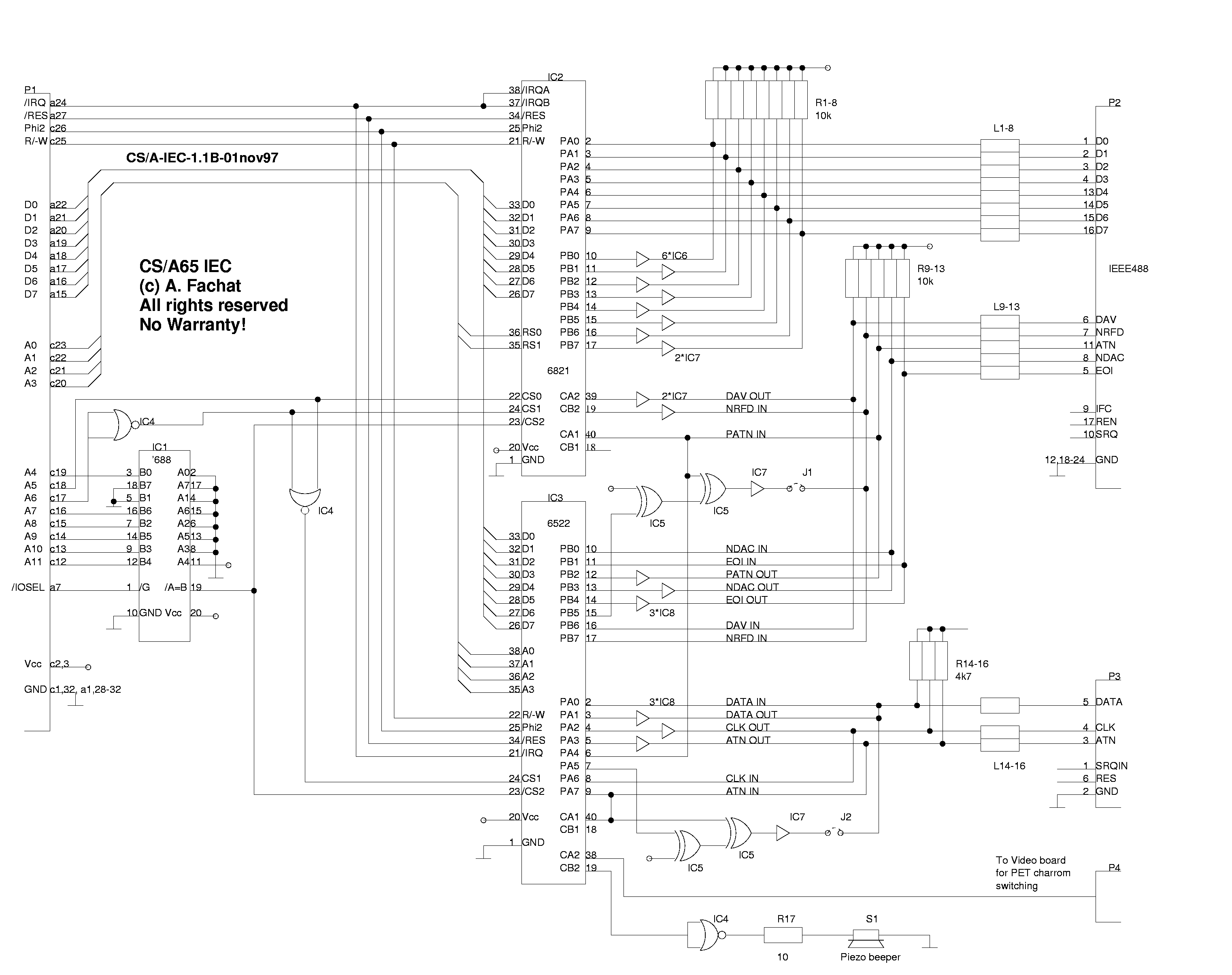

Version: 1.1B
Status: ok
Notes
This board is only partially compatible with the Commodore PET IEEE488 interface, although it uses the same I/O address. It adds, however, the ability to be used as a device (for both the IEEE488 and the IEC bus). | |
This board is deprecated. Please use the PETIO board instead. |

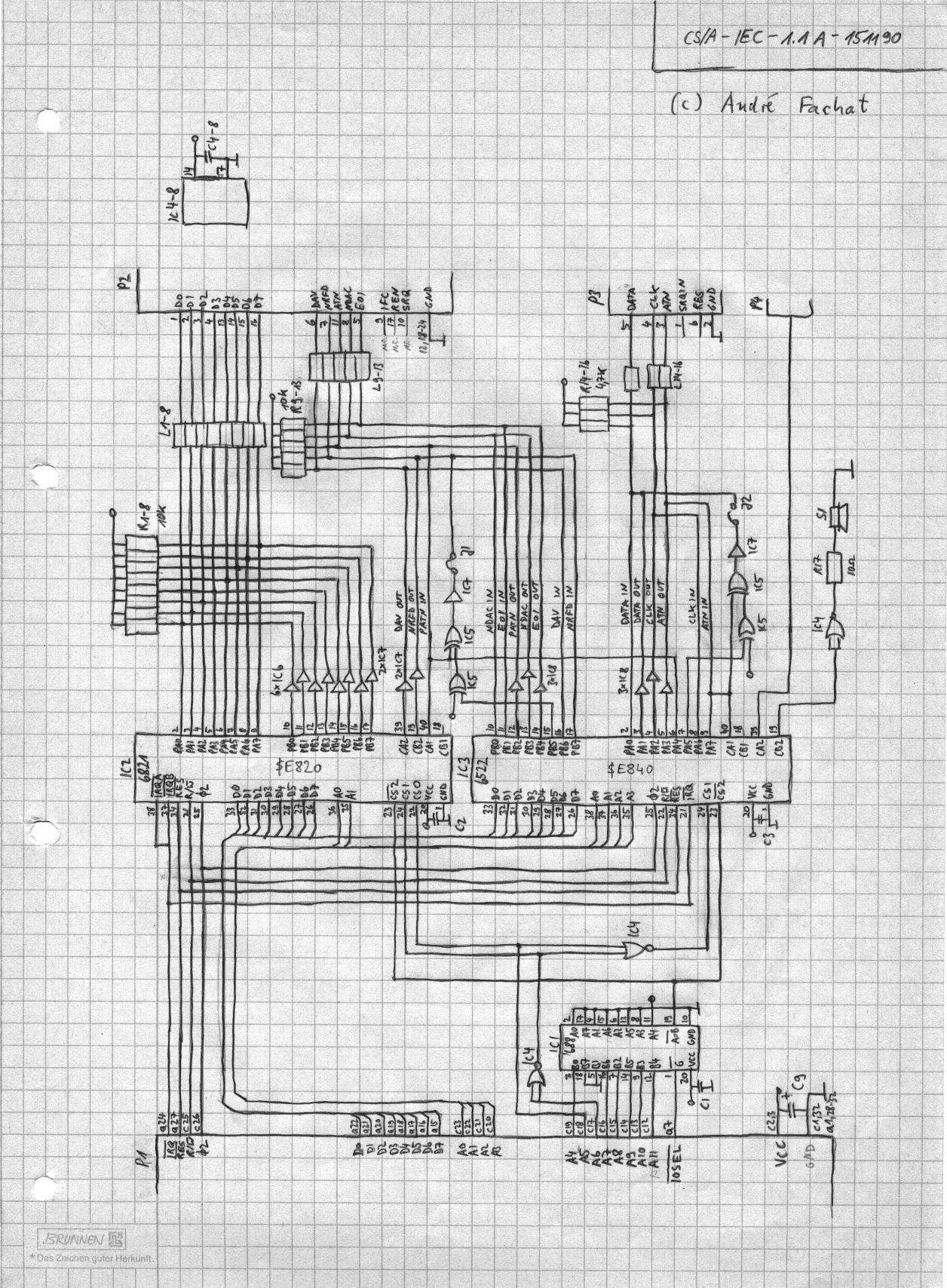

Version: 1.1A
Status: deprecated
Notes
scanned schematics only | |

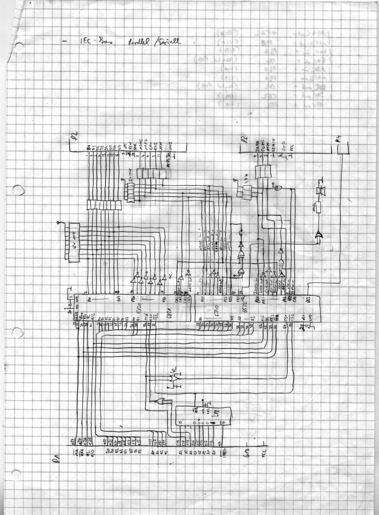

Version: 0.X
Status: deprecated
Notes
Files
csaiec-0.x-schem.png |
