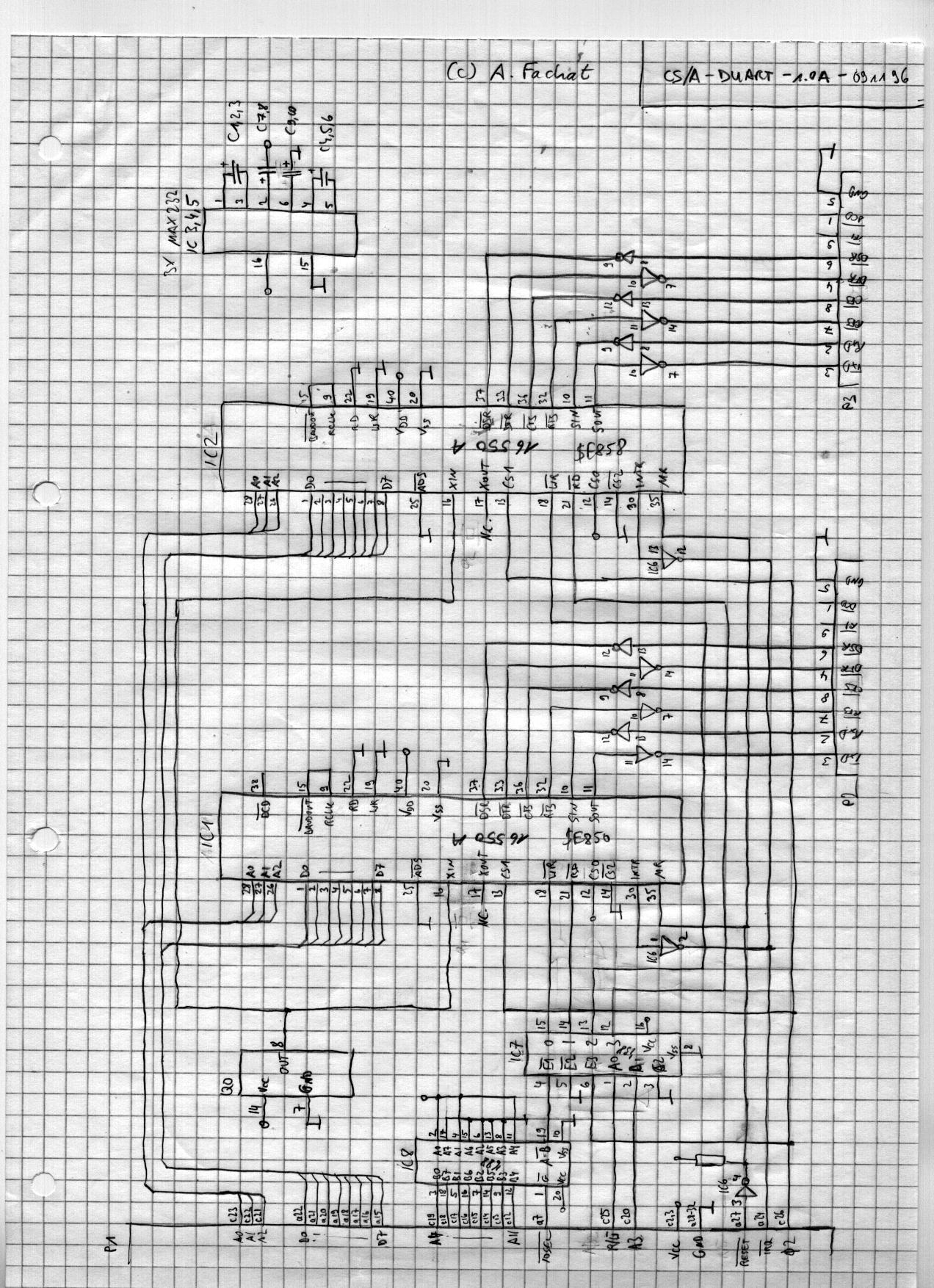

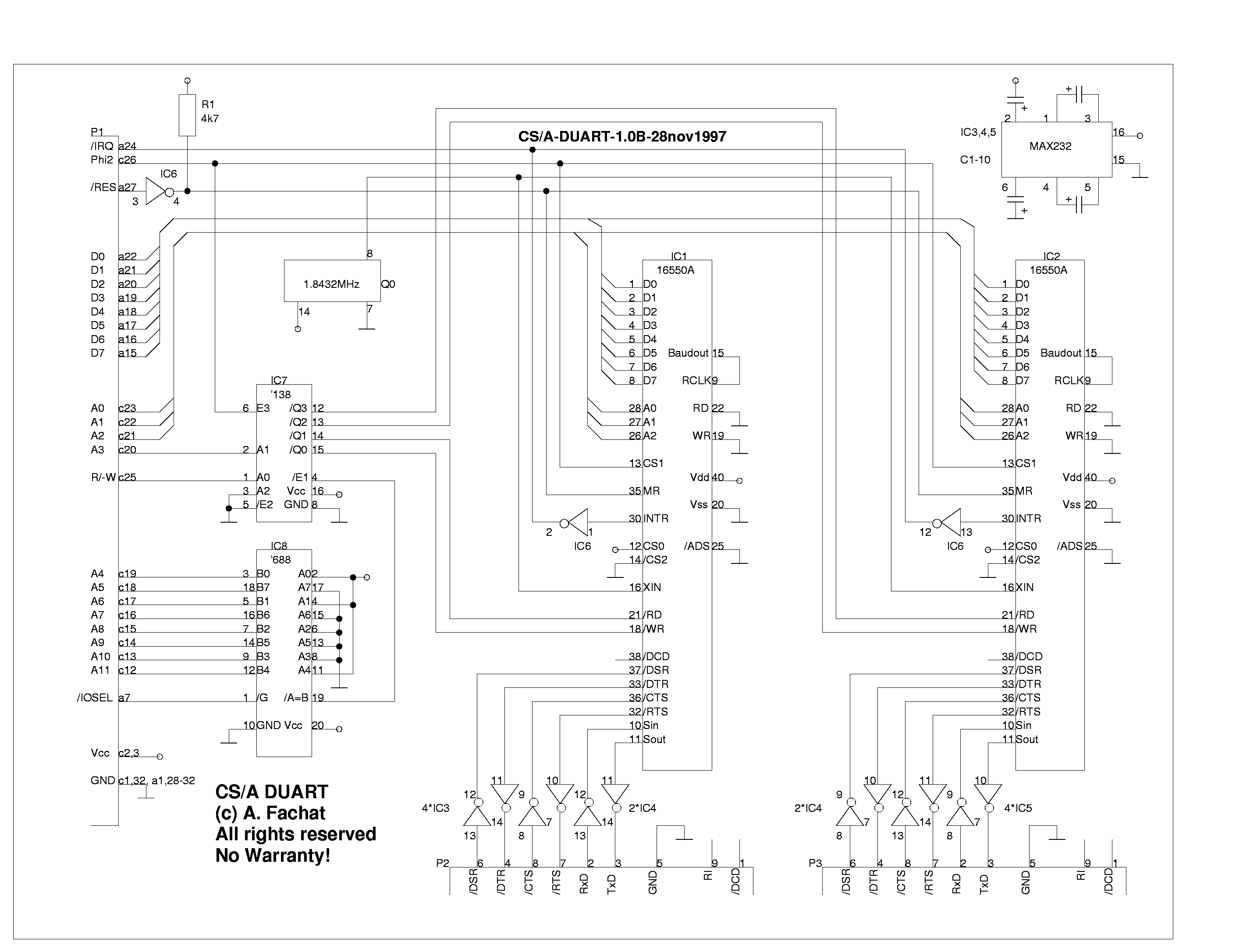

This Dual RS232 board uses two 16550A for the two interfaces. I know that there are ICs like the 16552(?) with two interfaces in one chip, but when I needed it, I had the parts at home already...

Version: 1.0A

This is the initial version (scanned schematics).
