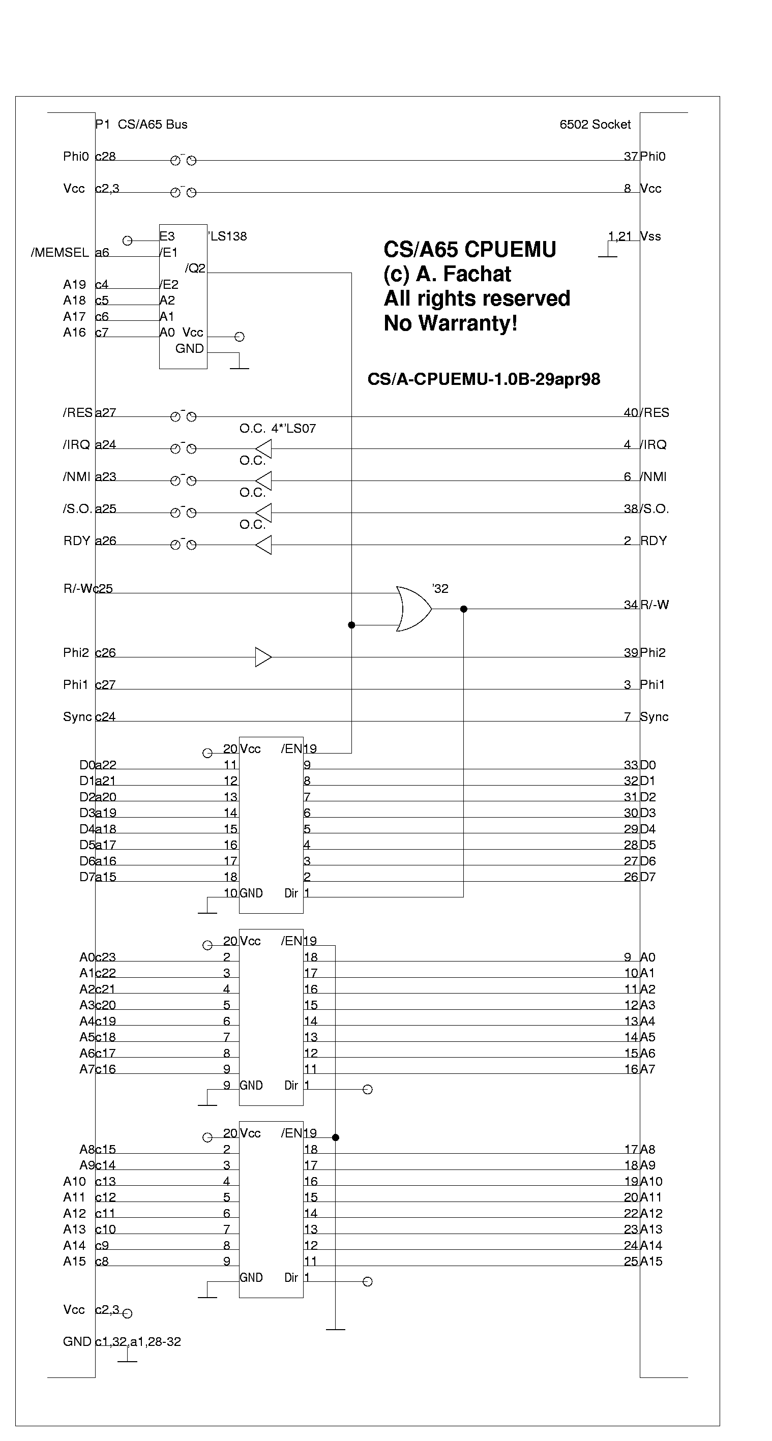

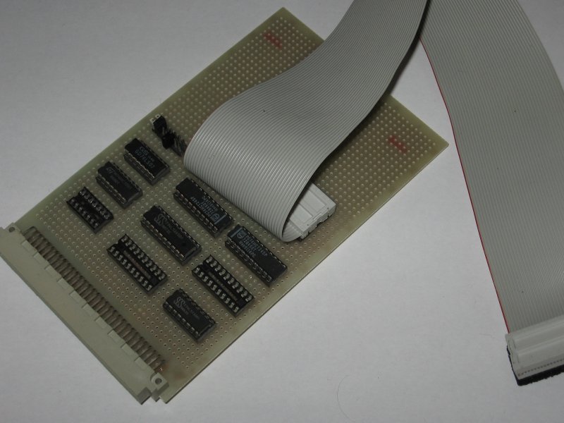

This board implements a 6502 emulator.....: it allows the CS/A65 bus cpu to emulate a 6502 cpu on another computer. I.e. it utilizes a 40pin cable to connect to a 6502 socket on another computer, where the original cpu has been replaced. This allows to map the 64k memory of the emulated cpu into the 1MByte address space of the CS/A65 bus. Using the MMU for example the ROM space of the emulated cpu can be replaced with (write-protected) CS/A65 RAM, to test new ROM versions. I have successfully tested new Commodore VC1541 ROMs with this system.

csaemu.jpg(The unused sockets were planned for a - so far - unimplemented 6510 processor port)
