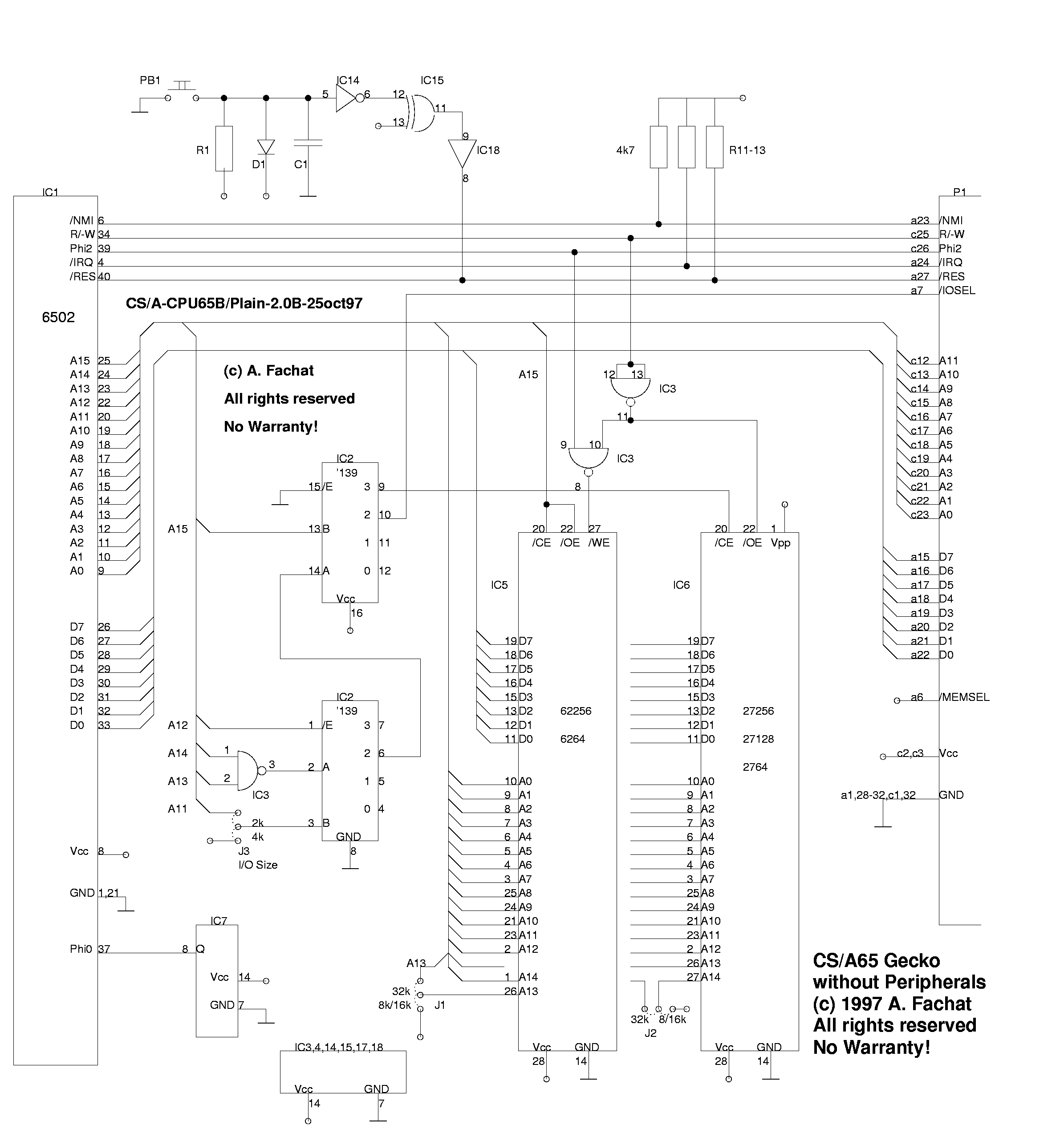

CS/A65 CPU65b
This board implements a 6502 processor board for the CS/A65 bus system. Compared to the main cpu, however, it only utilizes 64k memory without an MMU, and can thus only use the I/O address space on the CS/A65 bus.
    2006-11-01 Board is deprecated. Use PETCPU board instead.
Table of content
Version: 2.0B
Status: draft
Notes
This board is derived from the Gecko board, in that the Gecko I/O circuitry have been removed.
This schematics has not been tested.
This board is deprecated. Please use the PETCPU board instead.
