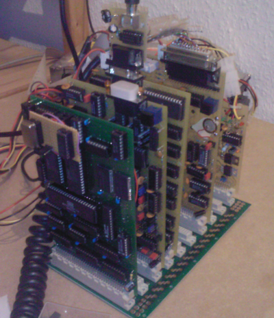

This board implements a 65816 CPU board for the CS/A computer. The CPU runs on eight times the bus clock speed, i.e. for a 1 MHz bus, the CPU runs on 8 MHz. Currently only 1 MHz bus/8 MHz CPU is supported though. It features up to 2 MByte fast RAM that is used at CPU speed. To access the bus memory and I/O, the CPU is slowed down to bus clock speed with the RDY pin.
This board is almost all in standard logic, only for the timing-critical parts I had to use a GAL. The board has been superseded by CPU816 V2 which uses a CPLD as main logic element. If you don't have access to a Xilinx CPLD environment or don't want to use them, you may still want to look at the version 1 page here.

The 65816 board took a long time in the making. First of all, to get the amount of memory I had imagined, I had to resort to using SMD chips for the memory - something I had not done before, but it worked out well.
Also, to get the necessary short delay times in the logic signals, I also had to use a GAL programmable logic IC. I did not want to use such an IC for a long time, as it requires a separate programmer. Also I wanted to build the systems in a ways that are easily understandable from the schematics - in a GAL you can hide a lot of 'magic'.
Then of course there were the first bugs of the brown paper bag
quality - for example I completely forgot the logic about the XBE
signal, i.e. IC21D, IC20B and IC21C.
This of course made the data bus driver for the CS/A bus a continous driver.
A '573 replacement fixed for bank 0 - an essential debug tool.

A 65816 setup with BIOS, VDC, PETIO and PWR boards. Note that the CPU816 board is green, as opposed to the other boards it has protective paint on it so the SMD soldering would work.

Compared to the 1.1E board this board adds a 2k2 pull-up resistor on BRDY . Now
the CS/A bus RDY handling works, i.e. a CS/A bus board can slow down the CPU even more
if necessary.

The shown schematics has been implemented by patching up an older 1.1 board version. However, as there are too many differences, and I haven't yet done a new board layout, there is no board schematics. With the lessons learned from this version, I'd also rather make a new 1.2 version with a complete new layout. | |
There could be an issue with the VDC memory access. I am not sure if this is an issue with the 65816 board or the VDC board and the RAM chip it currently uses. I will check the VDC board with my newly acquired skills in drawing timing diagrams though. The issue shows is seldom stray writes into the video memory when scrolling the PET screen. May have been a bad soldering joint though, I currently cannot reproduce it. | |
Preliminary tests indicate that the BRDY handling is not yet correct, i.e.
when a CS/A bus board tries to slow down the CPU even more.
The TTL types are mostly 'ALS. Please refer to the parts list and not to the schematics for the TTL technology type. |

CPU816 top.PNG(65816 prototype board from top with replaced ICs ...) | |
CPU816 back.PNG(... and from the back - where you can clearly see its status too) | |
