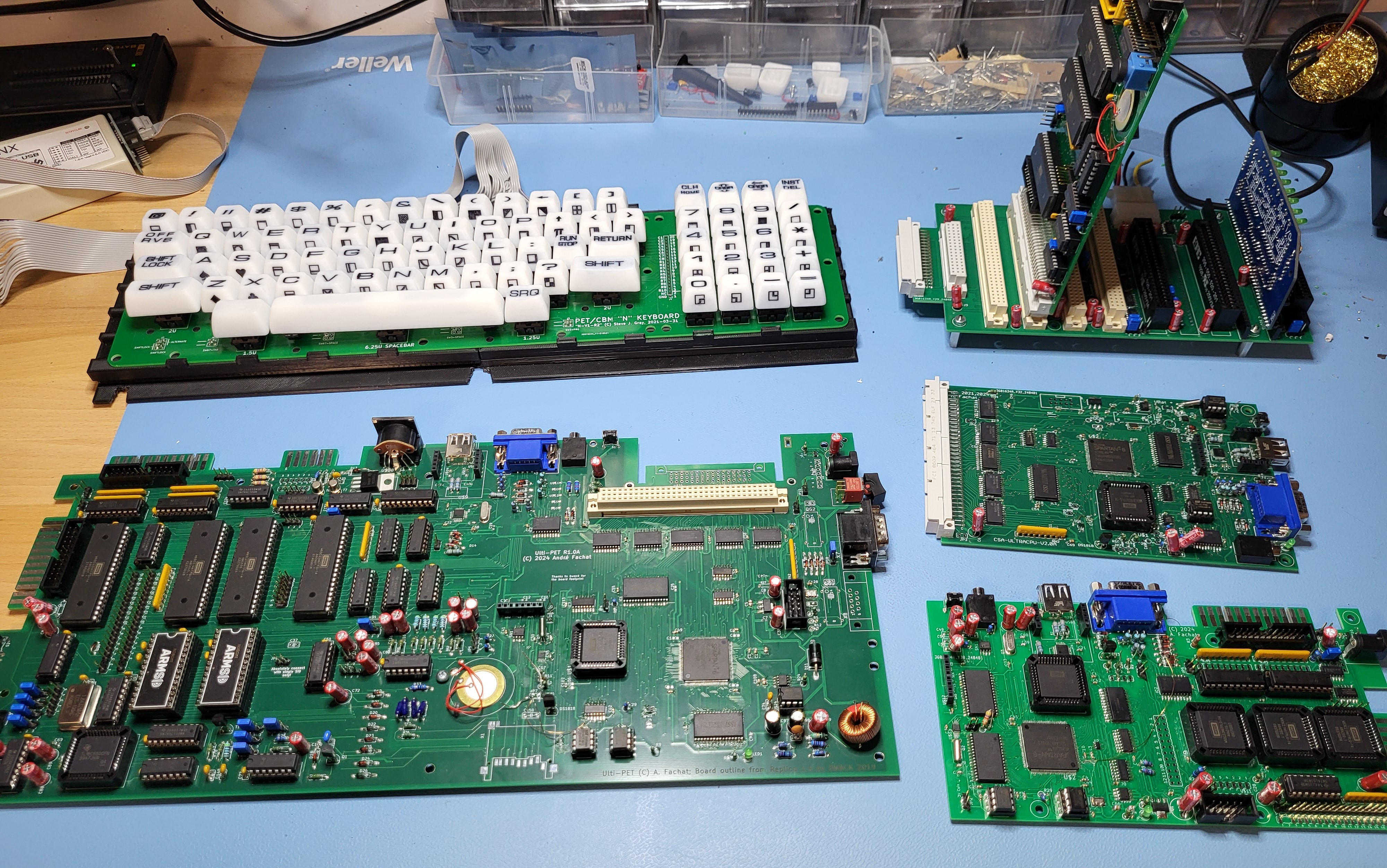

After building the Micro-PET I noticed, that for further features, I would have to get larger than a Euro-card. I started working with KiCAD, migrating some of my boards there and continued working on a larger version of the Micro-PET: The Ulti-PET.

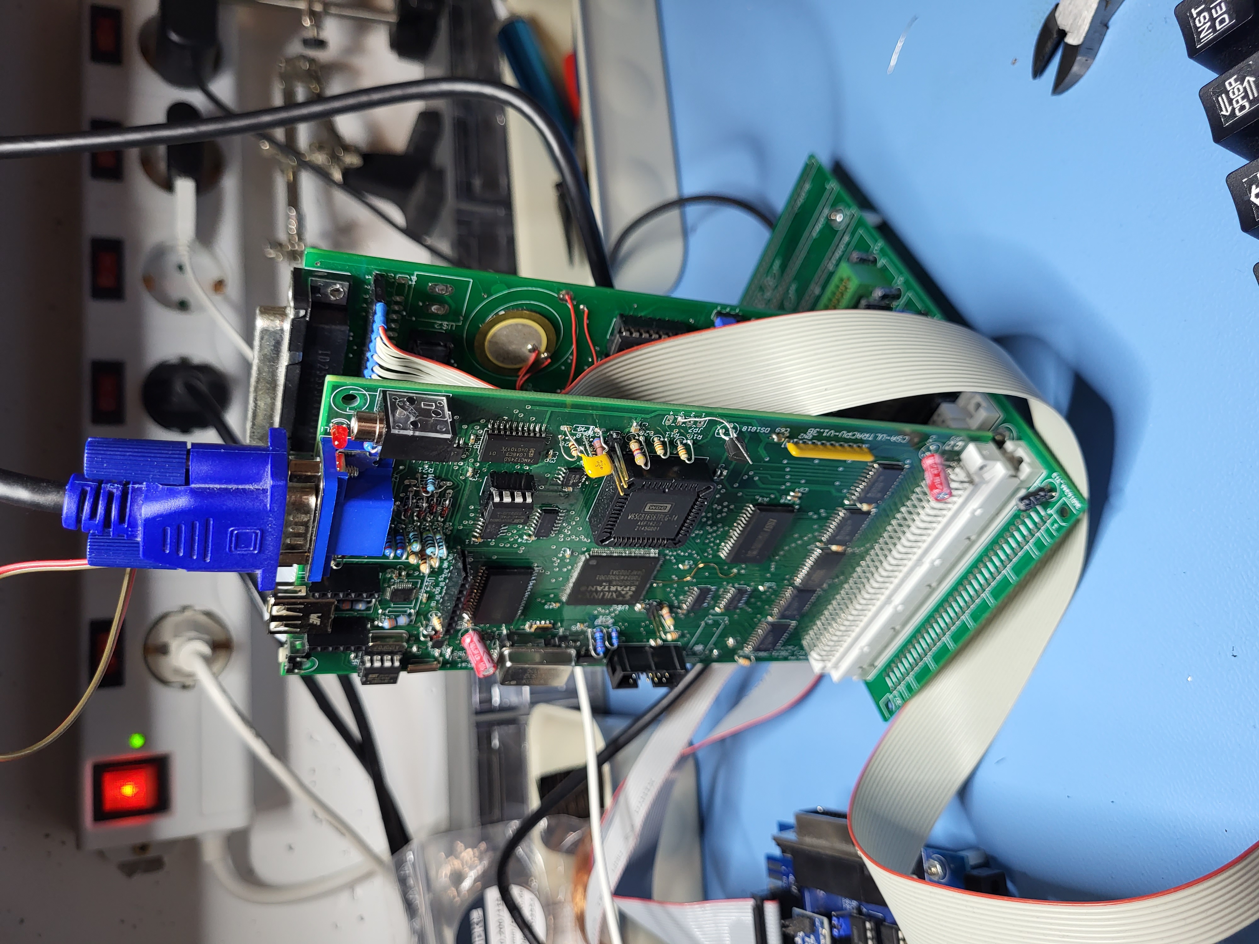

Finally, I reached a point where I was confident enough with the technology that I can now present three boards based on that tech:
  • The Micro-PET: a PCB that clones a Commodore PET, and adds modern features like SD-Card, USB, DAC audio, Network support, and colour VGA video output

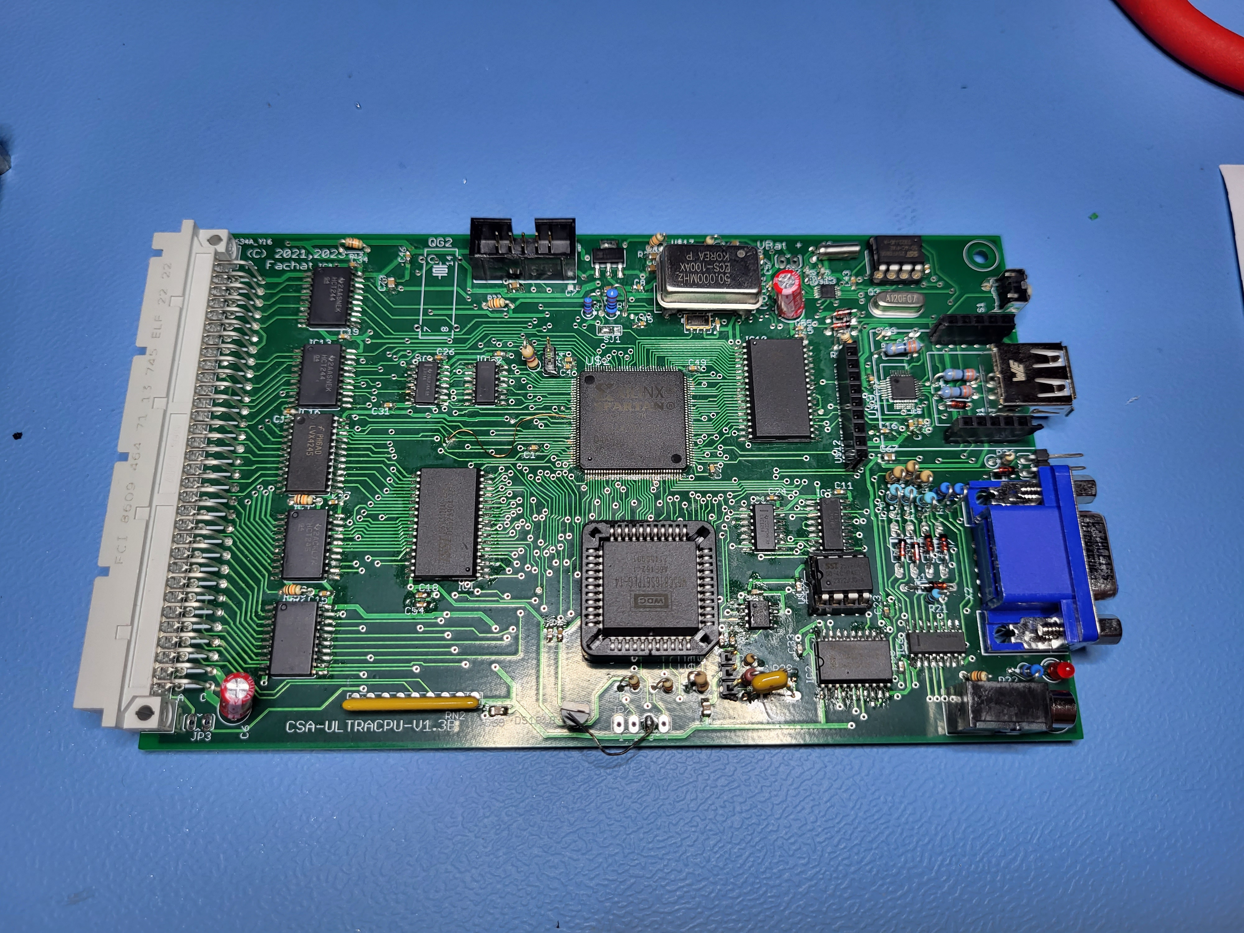

  • The Micro-CPU: The CPU and modern tech part of the Micro-PET (SD-Card, USB, DAC audio, Network, VGA video) as CPU for the CS/A bus.
  • The Ulti-PET: a Micro-PET-based PCB with many many new features like Dual-SID, I2C, RS232 / TTL UARTs, fast serial IEC, Joysticks,, ...
The main development is happening on github (see link left in the menu).
Status
All three boards have been tested. The Micro-PET and Ultra-CPU boards work. The Ulti-PET board needs some minor adjustments - the 2nd SID was not adressable, Joystick fire buttons did not work, some parts placement issues).
I am currently working on a new revision of the Ulti-PET board, which will be revision 1.2.

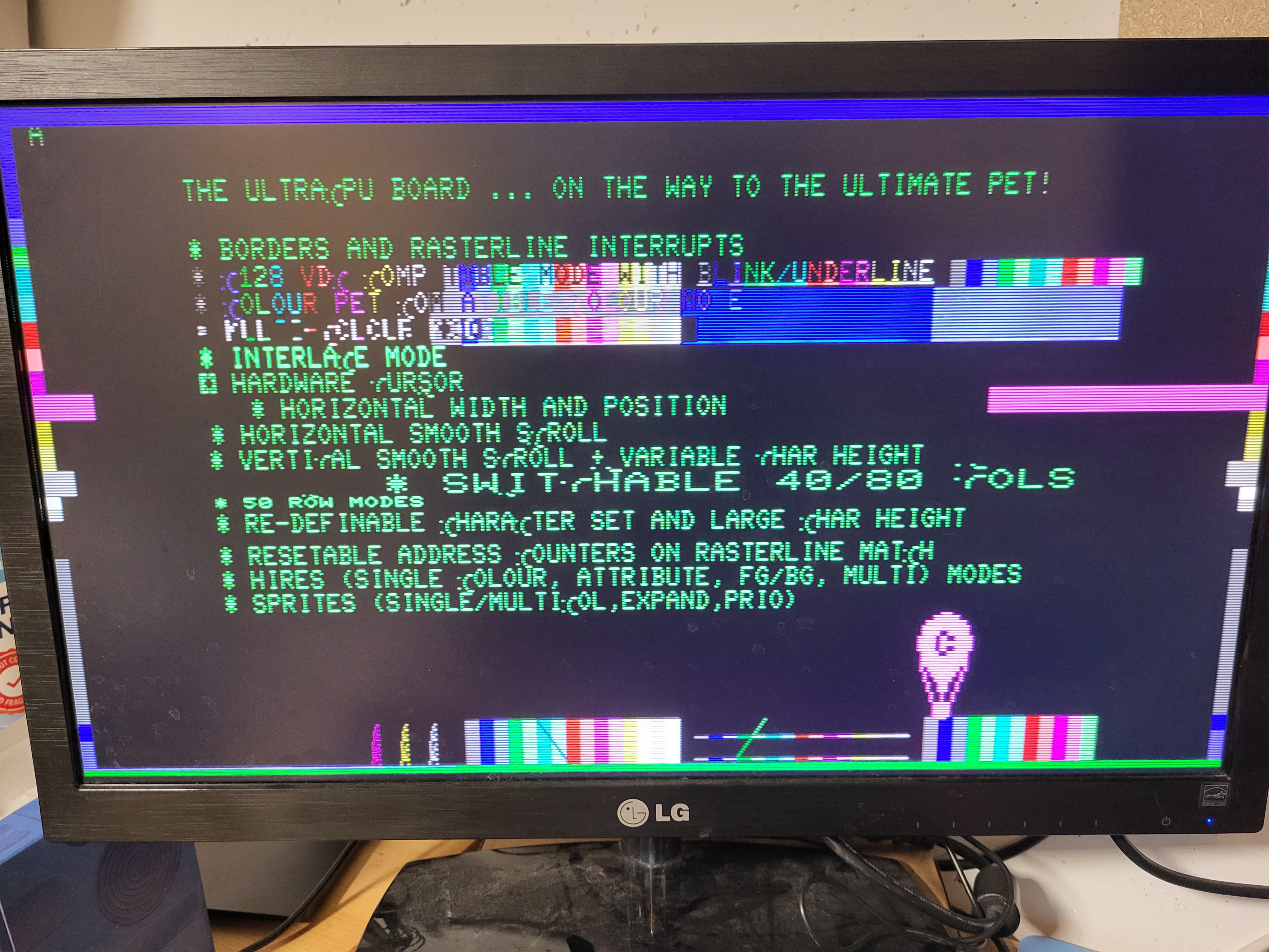

    • Improved Video output:
      • Multiple colour modes (Colour-PET, C128-VDC-compatible, Multicolour)
      • Colour Hires graphics mode
      • Sprites
      • Modifyable character set
      • 40/80 column switchable character width
      • Flexible timing, with up to 72 lines and 96 characters per line
      • multiple video pages mappable to $8000 video mem address
