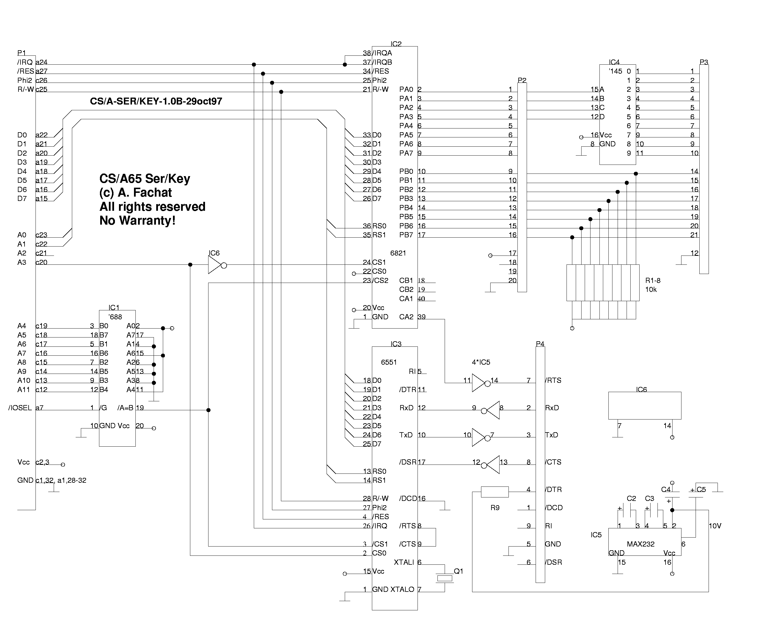

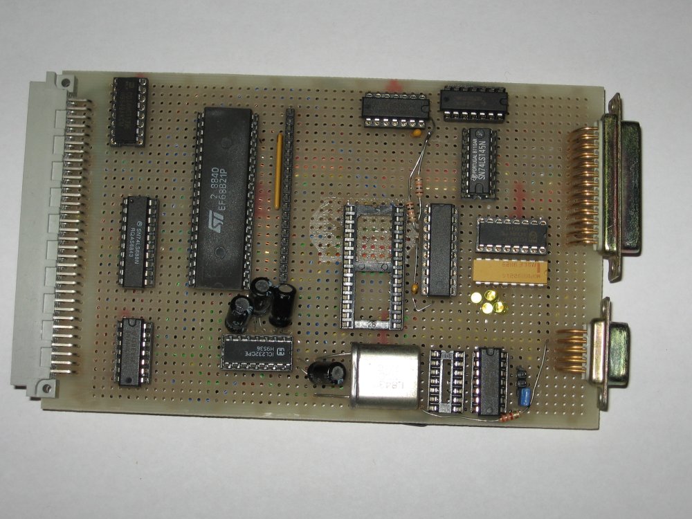

CS/A65 KEY+RS232
This board implements a simple matrix keyboard interface
that is Commodore PET compatible but can also use a C64
keyboard. It also implements a RS232
interface using a 6551 ACIA.

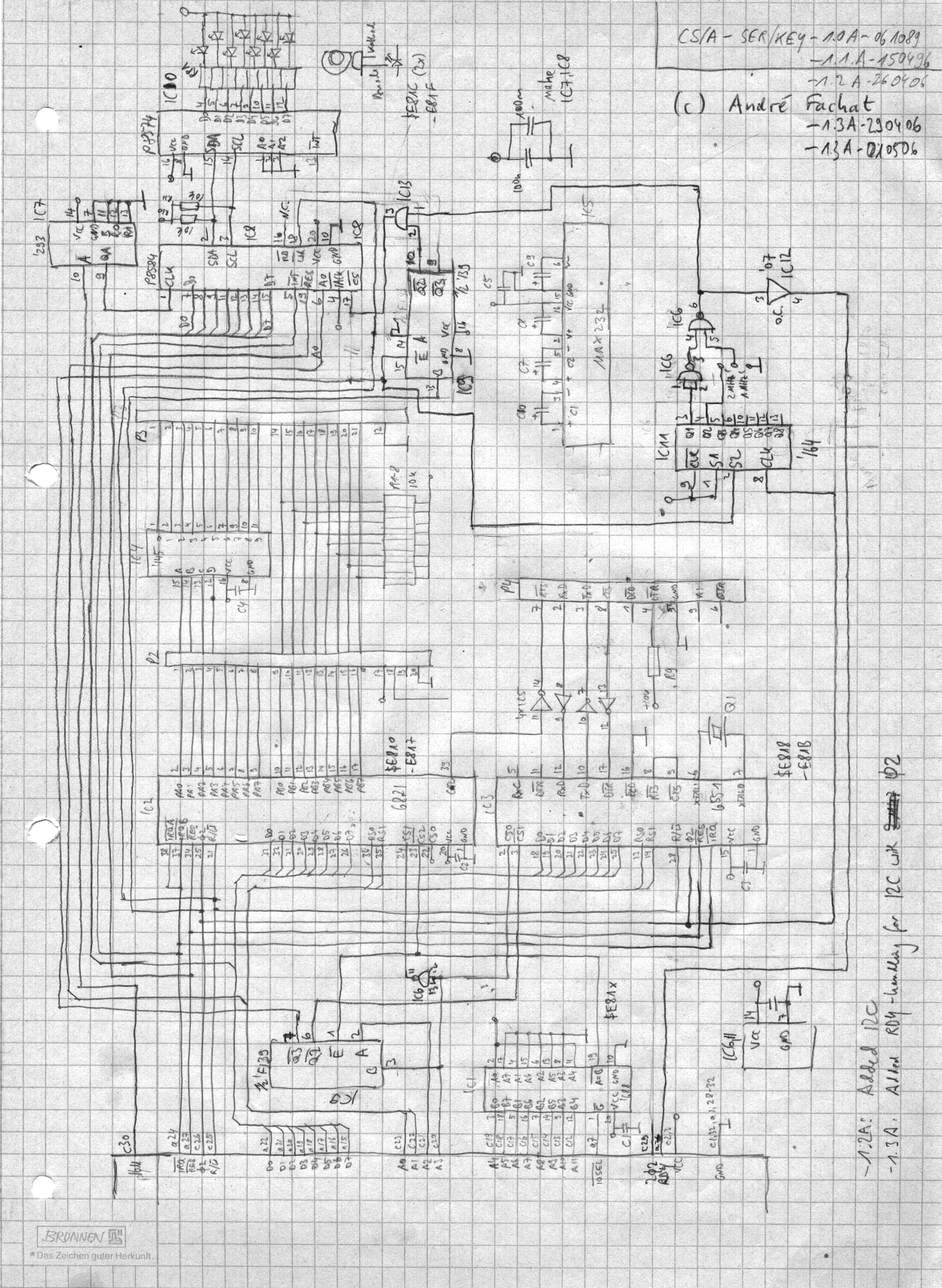

This board additionally implements an I2C controller with a parallel
I2C I/O chip and test-LEDs.

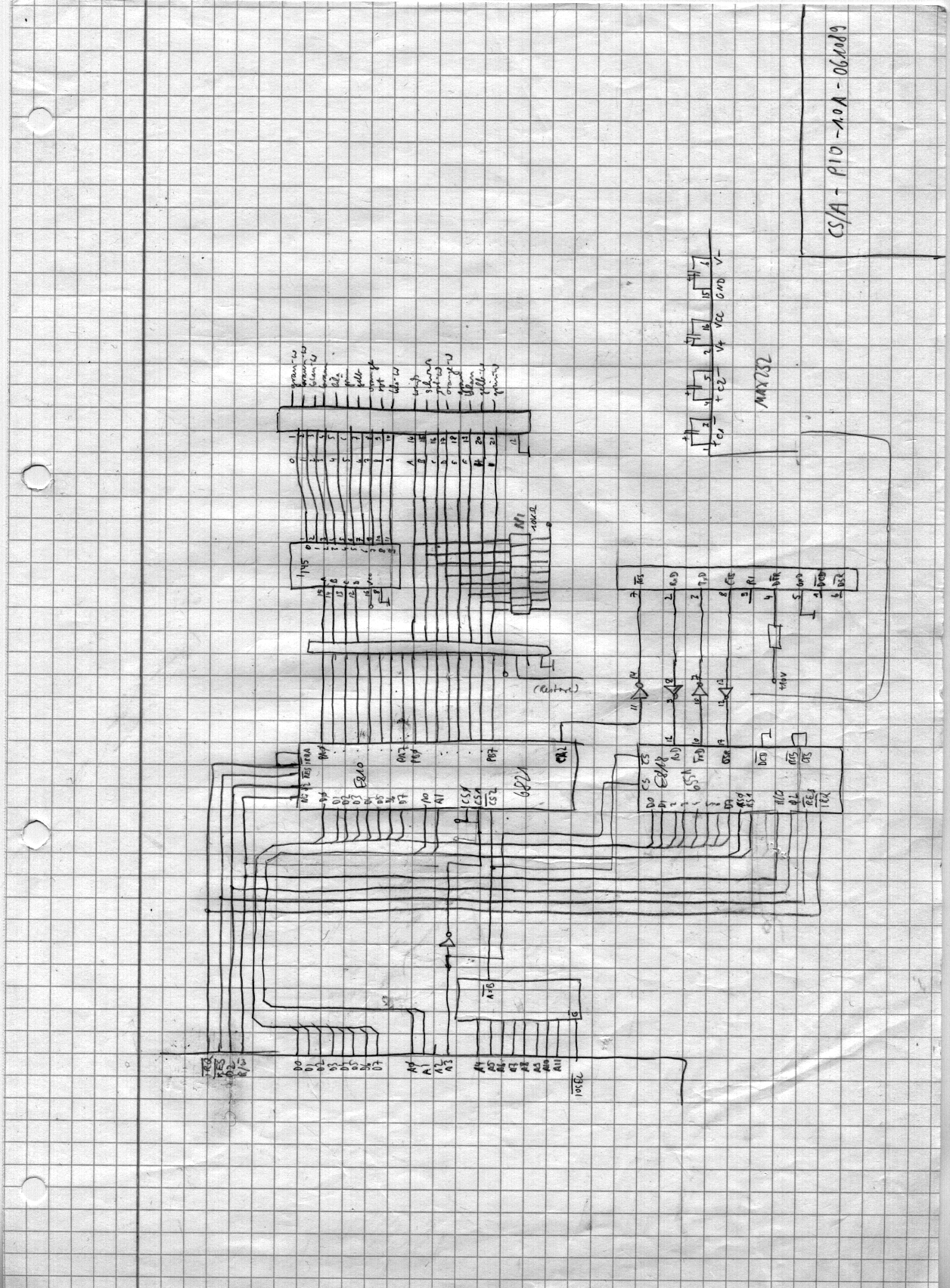

In the beginning this board went under the name of "PIO"...
