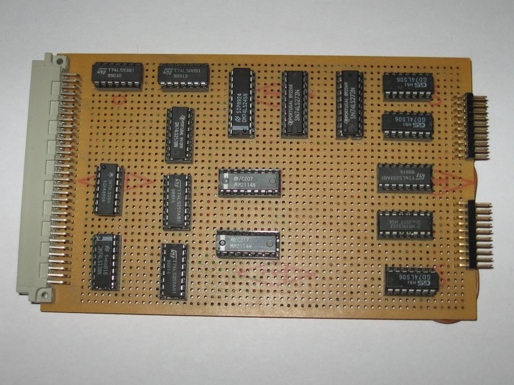

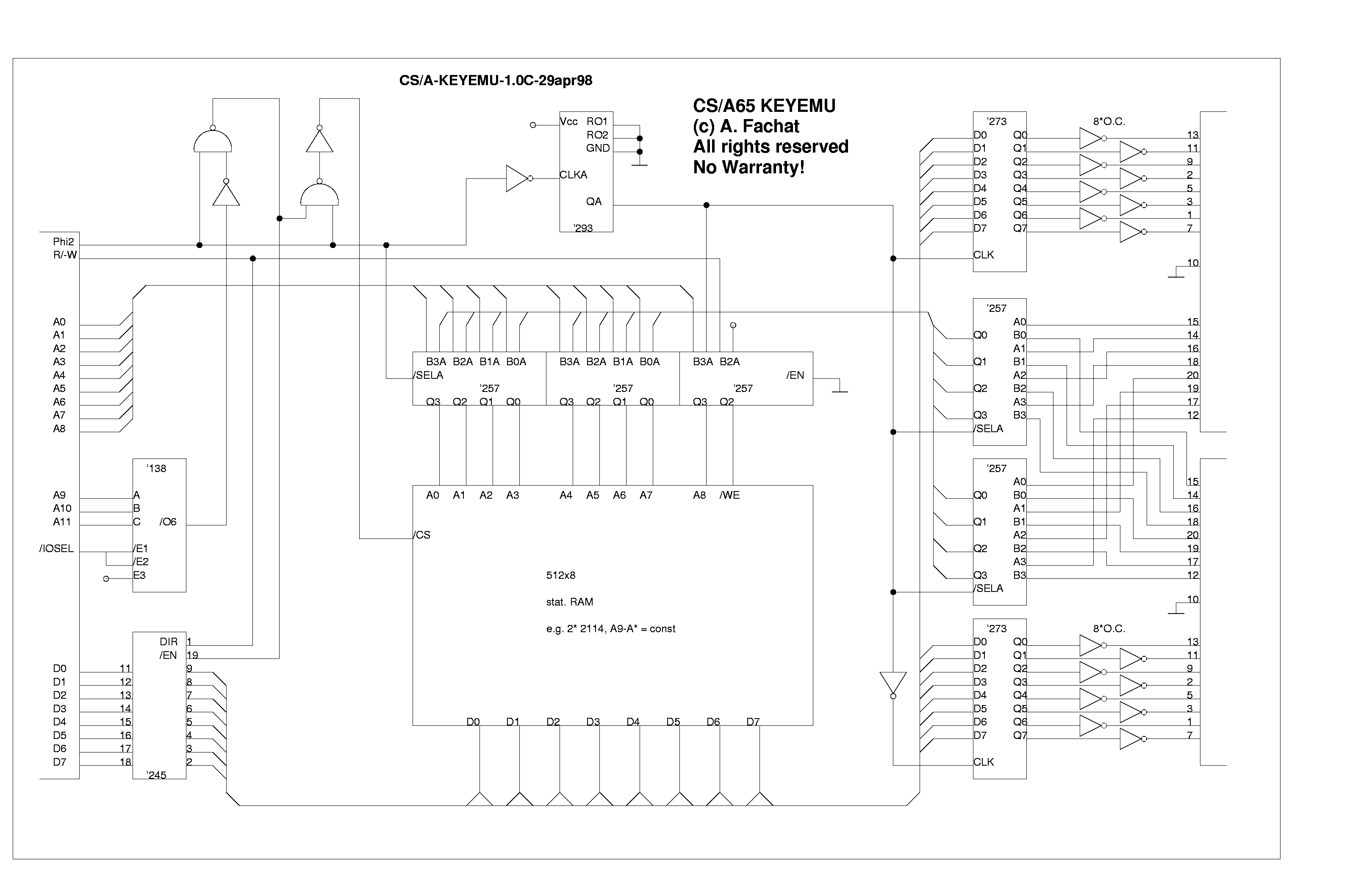

The board implements two keyboard ports with a 8x8 matrix each, using 512 byte of I/O memory.

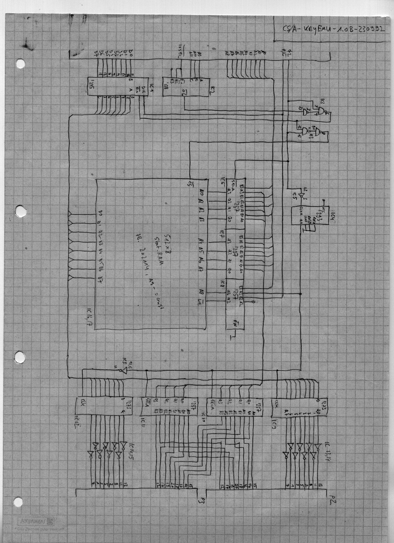

The original version (scanned schematics)

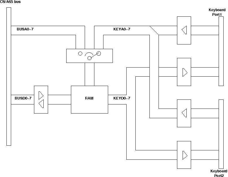

block diagram
The block diagram shows the dual access to the shared memory.
