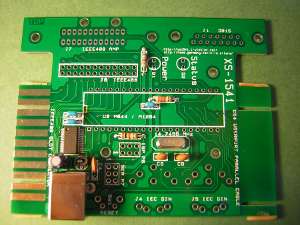

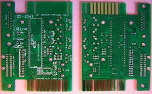

Hint on board connectors
![picture of XS1541](pics/xs1541_oben_300x225.jpg)

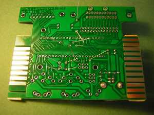

Unfortunately the given libraries for the board edge connectors where buggy, the slow connector is too narrow. If you use plugs without the coding bridges the connector could cause short cuts.
A pragmatic solution is to use small pieces of wood that are being cut to size and glued to the size of the card edges.

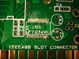

Soldering the SMD chip FT232RL
1. Put soldering flux on the pads for the FT232 onto the board
![SMD layout](pics/ft232_loetpaste_300x225.jpg)
2. Position the chip: The chip as a circle mark that notes the position of pin 1. This circle must be in the direction of the circle as on the board.
![SMD layout](pics/ft232_position_300x225.jpg)
The chip has to be positioned exactly on the pads! If the legs of the pin overlap two pads a short circuit occurs.
2. Fix the chip with a finger, and solder a single(!) edge pin - just put the soldering iron on the pin and pad (this works as the pads as well as the pin is already coated in solder, maybe depending on your board manufacturer). Check the position of the chip. If the chip has moved into a bad position, it can easily be moved back by heating up that single soldered pin. Then solder the pin on the diagonally separated edge.
Don't solder more than 2-3 seconds in a row!
![SMD layout](pics/ft232_gereinigt_300x225.jpg)
3. Solder the chip: solder the other pins by moving the soldering iron across all the pins (note: this only works with pads and pins being pre-coated with solder.)

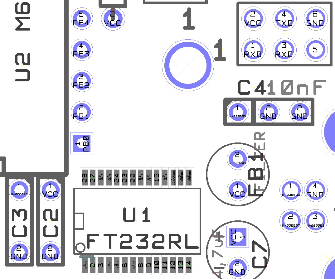

4. check the soldering work: check all the connections of the SMD chip against short circuits and connections to the actual signals. Do it now - later the FT232 it is much more difficult.
The pins are very close to each other, but can still be checked with a simple multi-meter.
There are 7 signals at 13 points to be checked.
![schematics detail](pics/ft232_detail.png)
Name | Probe point | Pin on FT232RL |
VCC | SER P7 pin 2 | 4 and 20 |
GND | SER P7 pin 6 | 7, 18, 21, 25, and 26 |
TXD | SER P7 pin 4 | 5 |
RXD | SER P7 pin 1 | 1 |
USB D+ | J2 USB socket pin 3 | 15 |
USB D- | J2 USB socket pin 2 | 16 |
3V3OUT | C3 pin 1 (top) | 17 |
If something went wrong and short circuits could be removed using soldering wick, the chip can be - carefully(!) - removed using a desoldering hot air fan (not a hair fan even though it looks like it!) The pads should be cleared from solder using soldering wick, then a new attempt can be started.

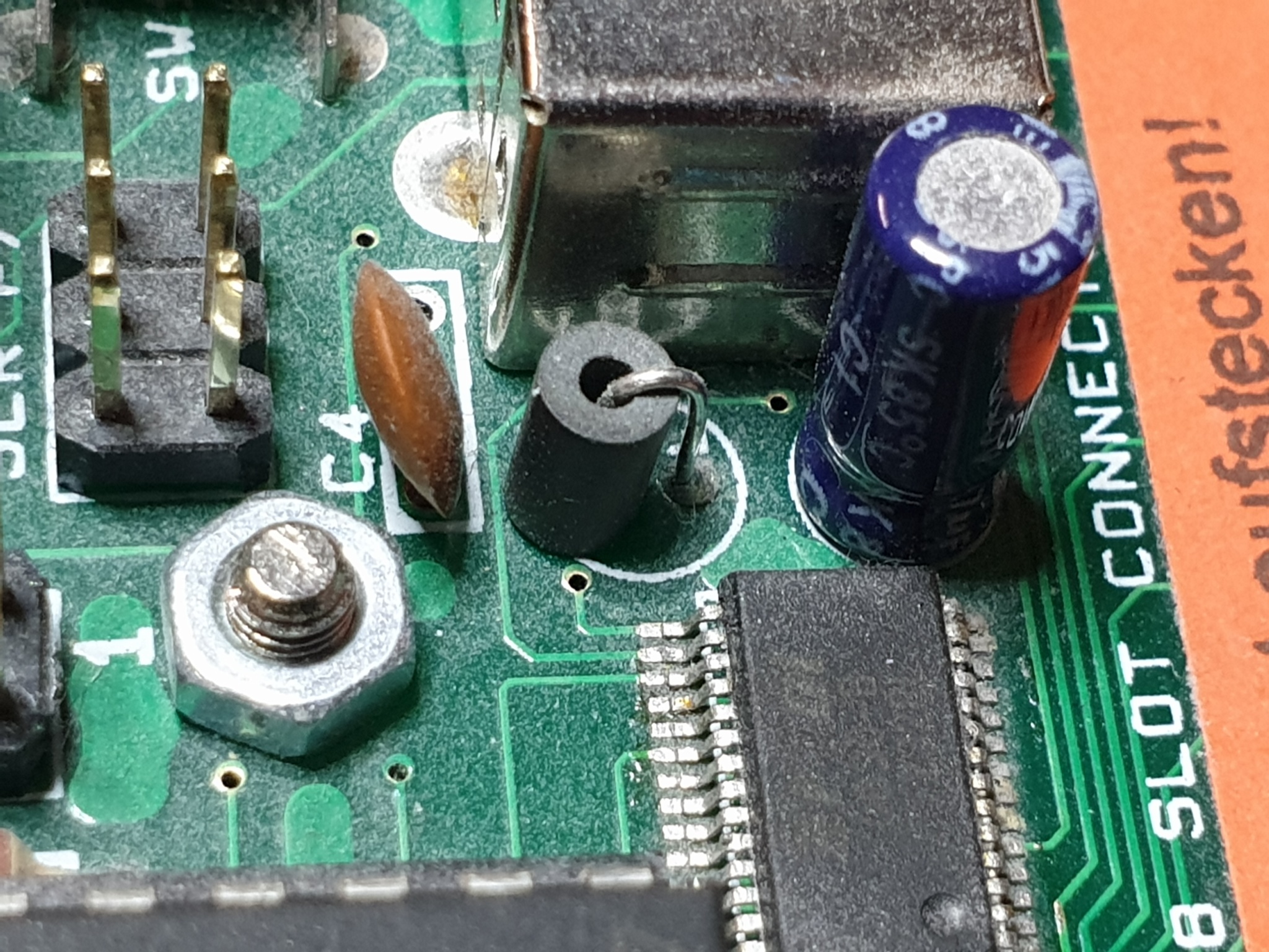

Please note that C4 on the board has three holes, even though a capacitor only has two connections. This is made such that you can use parts with a 2.5mm or with a 5mm pin distance. Just put one pin in the one of the three holes that is separated in the silkscreen print, and use one of the other holes as fits.
When soldering the caps, put the leads through the holes, bend them a bit so they don't fall out, and solder them in place on the bottom. Then cut away the rest of the lead. Don't throw the cut leads away (yet), you will need some of them later
Ferrit Bead
![SMD layout](pics/bead.jpg)
Take the longest of the leads that you cut from the caps, and put it through the ferrit bead, then solder the two ends to the board.

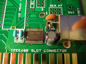

USB socket
![partly built board](pics/ft232_usb_300x225.jpg)
The USB connector will be soldered to postion J2 USB. The stabilizing pins don't need to be bent, but can be just soldered into their holes.

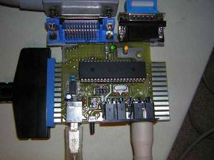

Rest of the discrete components
![partly built board](pics/xs1541_igel_300x225.jpg)
'Discrete' components are components with a single function, like resistors, capacitors, or crystals:
- R1 10 kOhm
- R2 680 Ohm
- R3 330 Ohm
- X1 Crystal 14.7456MHz
- C1 100nF
- C5 22pF
- C6 22pF
Before soldering it looks somewhat like a hedgehog...
![partly built board](pics/xs1541_diskret_300x225.jpg)

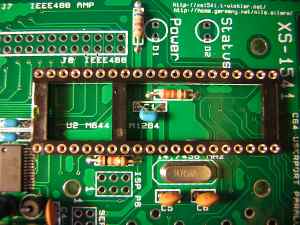

The socket needs to be oriented such that the notch matches the notch on the silkscreen print, left above the SMD chip. This notch determines how to insert the Atmel chip later and is thus quite important to get right.

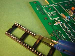

If the socket has a connection in the middle, like in the picture here, it may need to be cut away, so that it does not lay on top of the resistor.
The socket needs to be put into the holes such that it completely lies on the board with all pins going though the holes.
![partly built board](pics/sockel_ohne_steg_300x225.jpg)
Then solder pins 1 and 21 of the socket. Check if the socket is fully inserted and plain on the board. If not, heat one of the soldered pins with the soldering iron, and press the socket against the board. Repeat also with the second soldered pin until the socket fits. Then solder the rest of the pins.
After soldering all pins, gently bend C1 to the side so that it does not prohibit puting the Atmel chip into the socket properly.

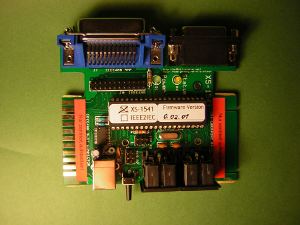

15 pin Sub-D, 24 pin IEEE connector (AMP), IEC DIN connectors
Placing those connectors on the board is a bit difficult. You need to make sure that all pins are getting through the holes and are not bent to the side.

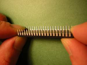

Preparing and installing the Atmel
![partly built board](pics/DIL_biegen_300x225.jpg)
The unprogrammed Atmel comes with the pins bent a little bit to the outside. It helps bending the pins to the inside so they have a 90 degree angle to the board, to better fit into the socket.
To do this you can gently hold the chip with its pins to a flat surface like a table top, and gently bent the pins.
Then the Atmel chip needs be put into its socket. It needs to go into the socket in the right orientation! The chip has a notch on one side that must correspond to the notch on the socket or silkscreen print.
First put the chip loosely on top of the socket, and control that all(!) pins are in the middle of the socket holes. If one pin is not centered, it could be bent when pushing the chip into the socket. In that case the chip needs to be taken out of the socket again, the pin needs to be aligned and another attempt started.
If all is good gently push the Atmel into its socket. Check if all pins are going into their socket holes. Continue until the Atmel is fully seated in the socket.
