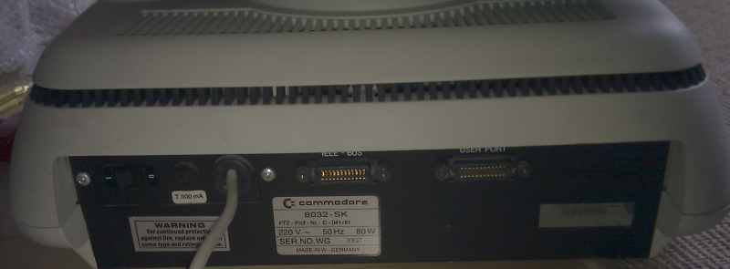

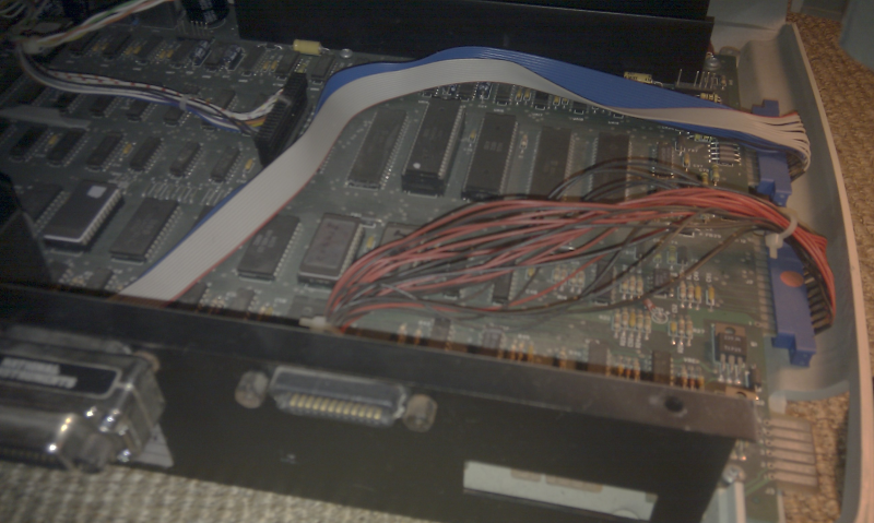

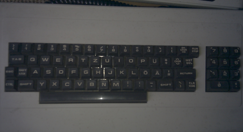

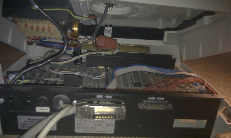

The result of this was the 8032-SK. It is in fact the old 8032 board in a new rounded case with swivel screen. But inside the case, the board is turned 90 degrees from its usual position - with the result that the user port and IEEE488 ports of the board are not at the back side of the computer. Thus Commodore used extra cables from the card-edge board connectors to the back side of the computer. There they added standard IEEE488 connectors (like on the floppy drives) for both the user port and the IEEE488 port. Also the keyboard needed to be connected with a separate cable from the board to the case connector (which is soldered onto the new board in the 8296)
As the board is quite large for the case, the transformer had to be mounted on the top part of the case (and not on the bottom as in the 8296).
