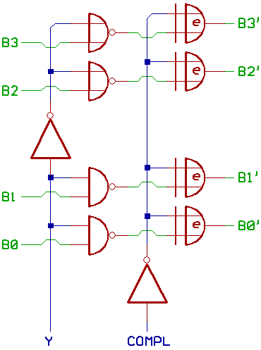

Now for the little box which turns B into B'.
Like with binary adders in some ALU design articles,
the box turns B' to B, /B, 0, or -1.
But because Excess 3 zero means binary 0011,
things are a little bit more complicated.

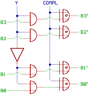

An alternative version:
