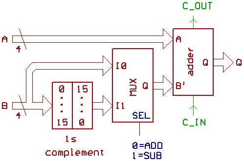

A simple 4 Bit binary adder/subtractor:
Q=A+B:
C_IN is a high_active carry,
the multiplexer routes B to the adder B' input,
it's simple.
Q=A-B
is less simple to understand.
Because we are using an adder,
we need to do something like Q=A+(-B).
In other words: we have to complement B
into a negative number.
-B is the 2s complement of B.
As we know from the school books:
in order to convert B into a negative number,
we first have to invert B into /B, then to add 1.
/B is the 1s complement of B.
The box labeled "1s complement" only contains
four 7404 type inverters.
For instance:
the 1s complement of binary 0000 (decimal 0)
is binary 1111 (decimal 15).
"But how to increment /B ?", you may ask.
The simplest way is to set the ALU carry input to 1.
So Q=A-B is done by this hardware as Q=A+/B +1
And because of that, C_IN now is a low_active borrow
instead of a high_active carry.
