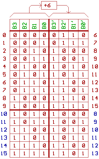

adding +6 to a number for BCD correction.

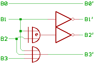

And here a neat +6 schematic, drawn from the
info gathered out of the 100181 datasheet:
Warning:
For input values greater than 9,
this schematic won't work !
The next page discusses the 100181,
so I felt a need to mention said schematic here.

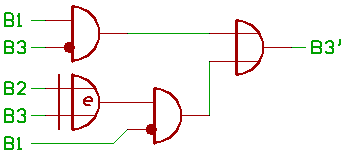

If you want to add 6 to the full range of numbers
from 0..15, the problem obviously is generating B3'.
A schematic derived from this table:

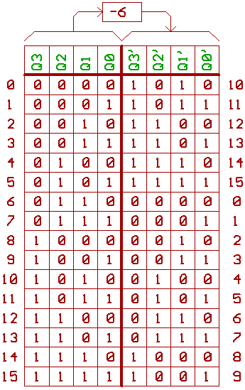

adding -6 to a number:
(or subtracting +6)
...Had to "invent" my own solution.

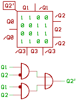

The Q2' signal:

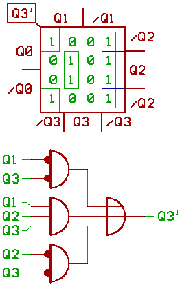

The Q3' signal:
And now my schematic for subtracting 6 from a number:
...Of course, the circuitry for generating Q3'
looks a little bit complicated.
When building 100181 styled BCD arithmetic,
you only have to subtract 6 from a set of numbers
from 6..15, and in that case, you could simplify
the schematic above for generating Q3' pretty much:
