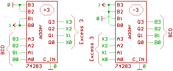

Once there was another concept, called Excess 3.
Basically it looks like adding 3 to the BCD code.
Point is, that the book claims, that using this sort
of code simplifies decimal adder circuits.

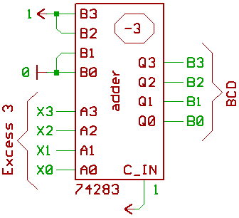

If you happen to have 4 Bit binary adders,
converting BCD to Excess 3 and back is simple:
We could draw the Excess 3 to BCD conversion a bit different:

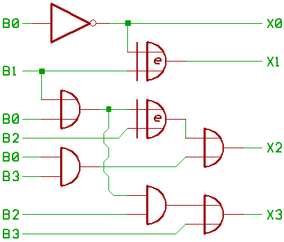

Converting BCD to Excess 3 by using logic gates:

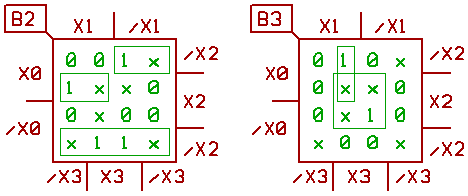

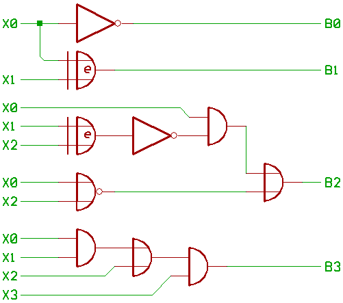

Unfortunately, I had no example for converting
Excess 3 back to BCD by using logic gates.
Here we go:
Schematic for converting Excess 3 to BCD:

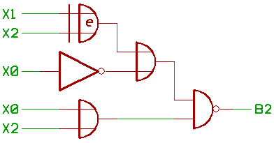

An alternative version for generating the B2 signal:
