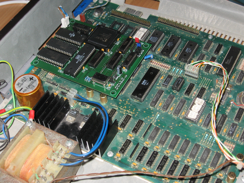

On this page I have put some pictures of the board and the benchmarks I did with the board.
Click on the images to enlarge

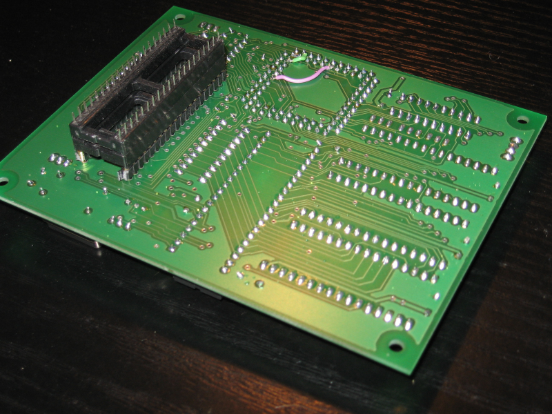

... and from the bottom. You can see the three bridges that make up the difference between V1.2A and V1.2B

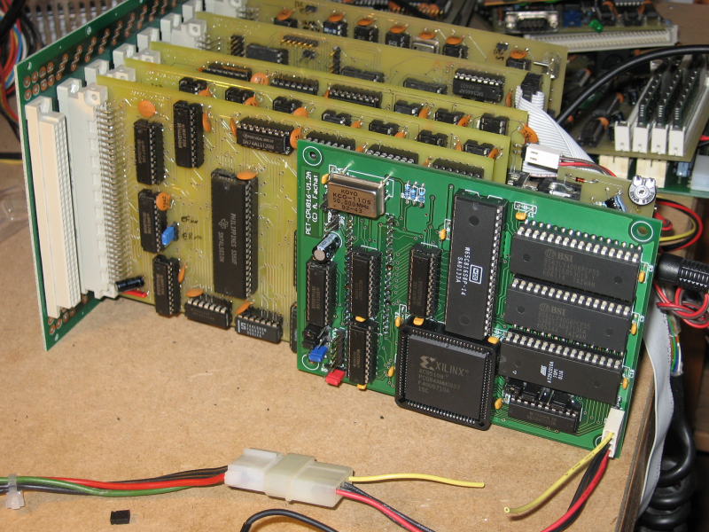

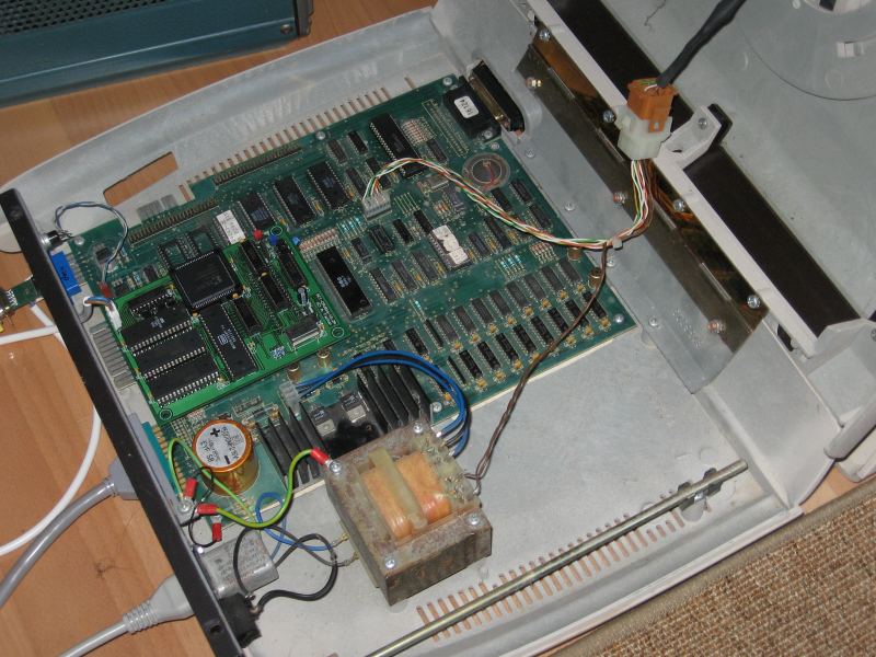

The test system with the board installed. The white connector at the left upper end of the board is an additional power connector, going to the tape port

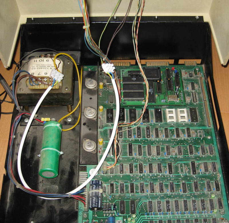

The board installed into the 8296. Here you see the additional power cable going out of the case and to the C2N232 connector I reused to get the power ...

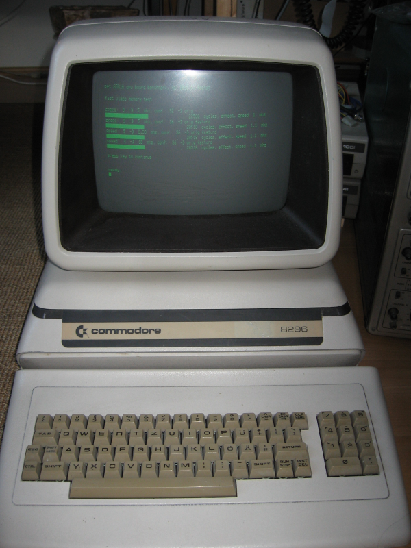

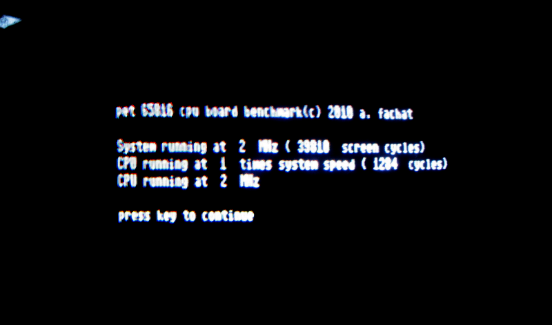

eah! The system runs at 10 MHz!

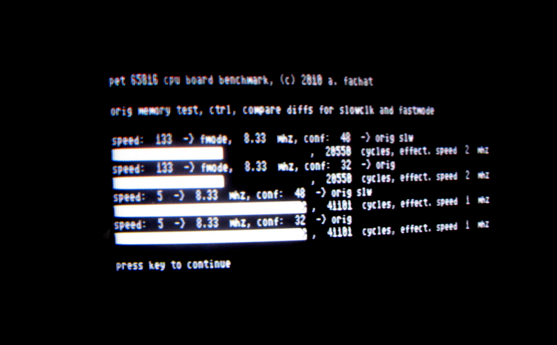

Each benchmark has two lines. The first line shows the configuration for the clock register ("speed"), and control register ("conf"), plus it names the actual bits that are set for convenience. The second line shows the benchmark result in terms of system cycles for the benchmark loop, and the speed calculated from that.
