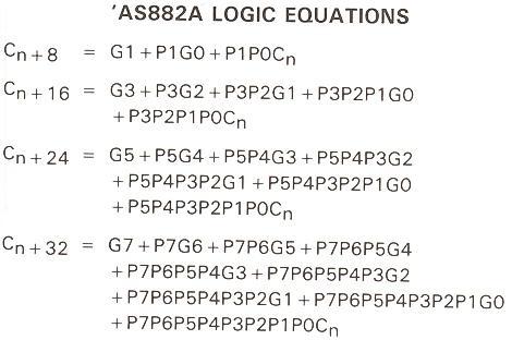

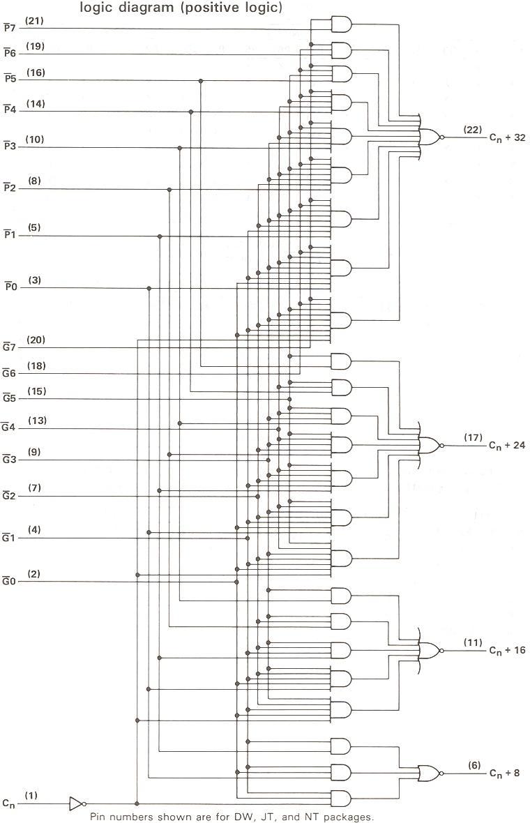

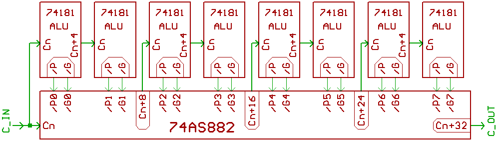

The somewhat exotic 74AS882 from TI was designed for linking
8 ALUs together... but it only had 4 carry outputs.
Makes sense, because it reduces the circuitry inside
the carry chain, and the wiring between the ICs looks
a little bit nicer.

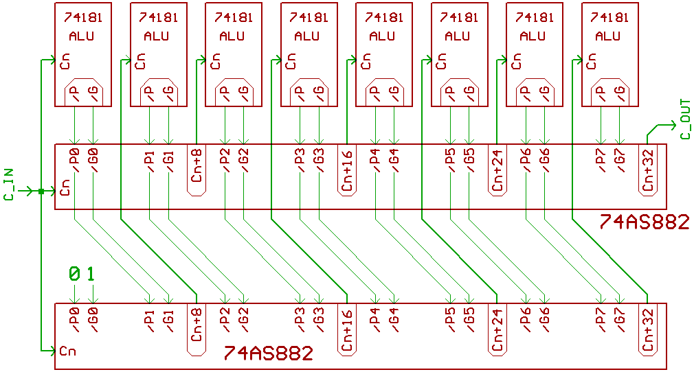

Using/abusing a 74882 as a "74182 replacement":
A trick of connecting two 74882 ICs together
for getting 8 fast carry outputs:

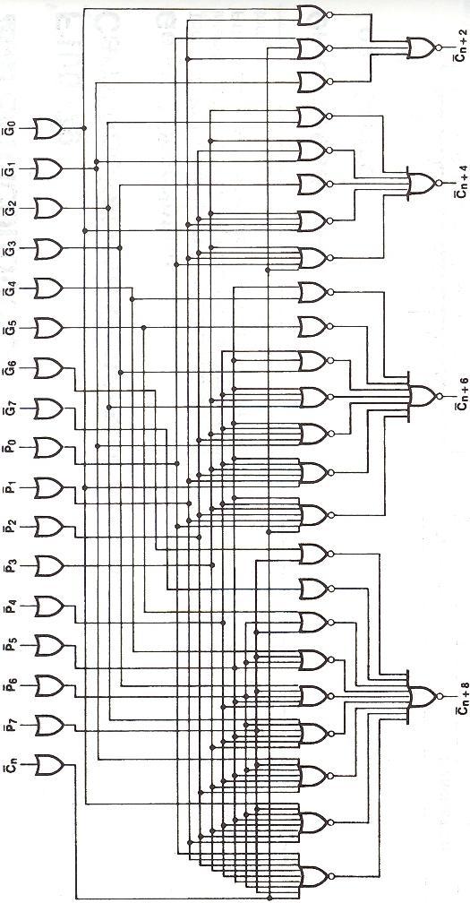

A similar IC was the 100179 (National Semiconductor),
except that it had a different pinout, low active /P, /G
and /Cn, /Cn+something signals... and that it was ECL.
