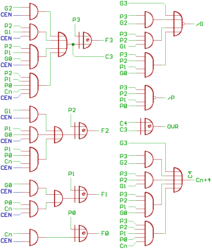

74381/74382 carry chain
Now for the innards of the box labeled "carry chain":
(I'm also showing the XOR gates connected to the outputs of the carry chain)
I guess, that them engineers who designed that IC
were a little bit paranoid when disabling the entire
carry chain if CEN=0.

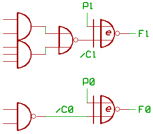

Of course, in the datasheet things look more complicated
and a little bit different. We may find AND NOR combination
gates, XNOR gates and such.
But for better readibility of the pictures, I decided to draw
the schematics with AND/OR combination gates and XOR
gates instead.
