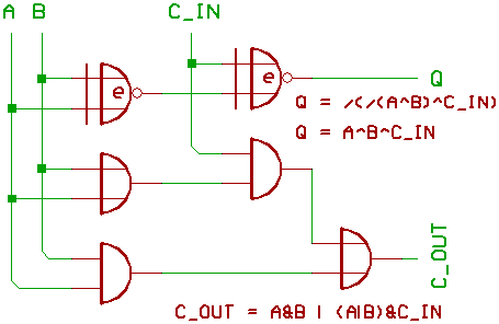

Now an example about building a one Bit full adder:
The schematic looks a bit unusual, because it's
optimised for the MC14500 instruction set...
which contains XNOR, but no XOR.
(Carry has to be set to 0 before processing the first Bit).
ADD1: ;Q=A+B+C -> ;Q = A^B^C, C = A&C | B&C | A&B
      LD   A ;three_input XOR: A, B, C.
      XNOR B
      XNOR C
      STO  Q ;store the result into Q
      LD   A ;if A = 1 or B = 1
      OR   B ;(we don't have an XOR instruction)
      AND  C ;and a carry goes in
      STO  C ;the carry is propagated to the next Bit.
      LD   A ;if A = 1 and B = 1
      AND  B
      OR   C ;generate a carry.
      STO  C
We could still optimise:
      LDC  A ;three_input XOR: A, B, C.
      XNOR B ;RR = A^B
      XNOR C
      STOC Q ;store the result into Q
      XNOR C ;set RR back to A^B. If A = 1 or B = 1...
      AND  B
      STO  C
