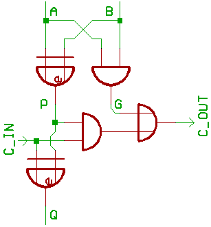

We are starting with the well known one Bit full adder,
which I did mention already in my previous ALU articles...
Just in case you forgot (or you didn't read them):
To make it short, Q = A + B + C_IN.
If A = 1 and B = 1, G = 1 and C_OUT passes the carry to the next higher Bit.
If A = 1 or  B = 1, C_IN from the previous Bit is passed trough to C_OUT.
Besides that, we generate Q with a three_input
XOR logic gate from the input signals A, B, C_IN.
Let's suppose, we are using 74HCT CMOS logic.
Component count for an 8 Bit adder would be:
4* 74HCT86
4* 74HCT08
2* 74HCT32.

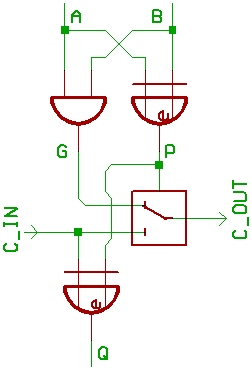

Now for a slightly different implementation:
Note the switch.
If A = B, the AND gate is connected to C_OUT.
Means, that if A = 1 and B = 1, C_OUT is 1.
If A = 0 and B = 0, C_IN can't get through.
If A <> B, either A or B is 1.
The switch then routes C_IN to C_OUT.
Component count for 8 Bit:
4* 74HCT86
2* 74HCT08
3* 74HCT4053.
So we need less components than with the previous schematic,
and maybe the signal passes faster trough the switch than
trough an AND/OR gate...
(Take care: when wiring too many such switches in series,
there is a chance that the capacitance of the 74HCT86 inputs
may slow down your signal.)

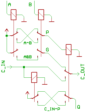

Talking of switches, we now try something different:
Two-Pole-Double-Throw Relays.
It uses the same concept as our prevous 74HCT based schematic.
A, B control two relays, which emit our AND/XOR signals.
P (propagate) will feed/propagate C_IN trough to C_OUT, if A = 1 or B = 1.
G (generate) is used to generate C_OUT, if A = 1 and B = 1
Again, we use a three_input XOR to generate Q out of A, B, C_IN.
