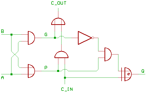

A simple 1 Bit binary full adder with ripple carry.
Not much to say.
If A=1 or B=1, Carry C_IN is propagated (P=1) to C_OUT.
If A=1 and B=1, a Carry is generated (G=1), setting C_OUT to 1.
When A=1 or B=1, but not both of them, and C_IN=0, Q=1.
Q gets inverted, if C_IN=1.

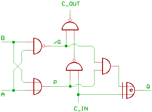

Now to optimize for speed and size.
For more speed, we could use two 74151, both of them
connected to C_IN, A, B at the select lines.
One generates Q, the other C_OUT.
If we draw the multiplexers at gate level,
and optimize for size, the result
may look a bit like the obsolete 7483.

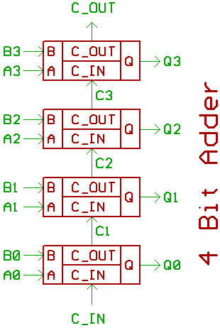

Connecting four 1 Bit adders together:
Unfortunately, carry has to pass through a lot of gates.

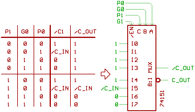

Time for another 74151 8:1 Multiplexer trick.
We are not limited to three inputs when evaluating
logic functions on the 74151, because it has a low_active
output enable.
Also, who said that the lookup table has to be
only made up with constants ?

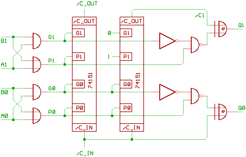

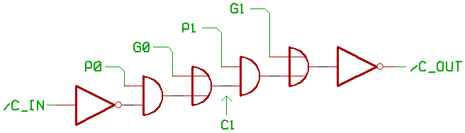

A carry chain for 2 Bits, consisting of two AND/OR gate,
to be crammed into one 74151.
Note, that carry_in is low_active, because we have
to abuse the low_active output enable as OR_term.
And now an example how to use it.
Note, that 74151 has two outputs:
one inverted, the other non_inverted.
Could be three times faster than the NAND version,
but not quite as fast as the 74F182/74S182.
