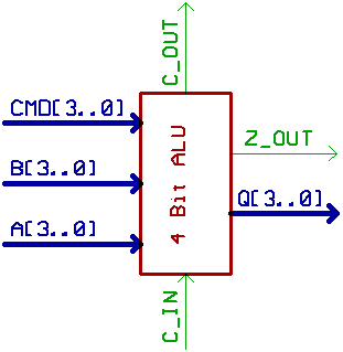

4 Bit ALU with EPROM
An example of a simple ALU.
Two input_busses, 4 bit each.
4 Bit command.
Carry and Zero_Flag.

 //EPROM:
 //A0..3=A, A4..7=B,   A8..11=ALU_command, A12=Carry_in
 //Q0..3=Q, Q4=Z_Flag, Q7 =C_Flag
