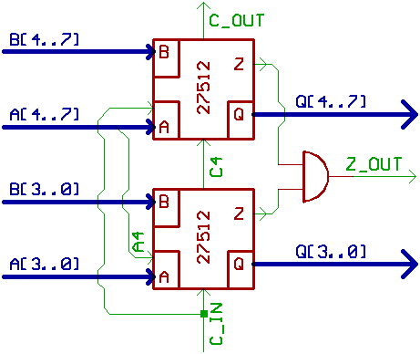

8 Bit ALU with EPROMs
When "only" building a simple 8 Bit CPU,
connecting two EPROMs together like 74181
is the simplest way to go.
However, some care must be taken for shifting Bits,
especially to the right.
The lower EPROM that emits Q3..0 must have
at least one additional Bit at one input_Bus
(A4..0 or B4..0, for instance).
The upper EPROM with Q7..4 requires to be connected
to the Carry input and output from the lower EPROM.
Also note, that we need a logic AND between the
Zero_Flag outputs from both EPROMs.
(ALU_control lines not shown.)

Unfortunately, carry has to go through both EPROMs,
so for arithmetic operations this ALU shows twice
the delay time of one EPROM.
(180 ns when using 27512/90ns, plus the delay
of the AND detecting the Zero Flag)

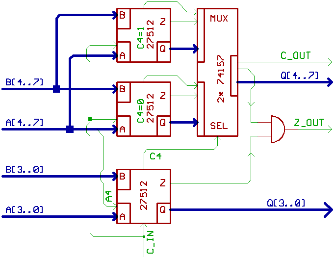

A trick to speed things up is to use three EPROMs.
One for Bit 3..0, two for Bit 7..4.
Two different lookup tables for the two upper EPROMs are needed,
assuming that c_out from Bit 3..0 may be 0, or 1.
The carry output of Bit 3..0 from the lower EPROM
controls 2:1 Multiplexers (74ACT157), for switching
between both of the upper EPROMs.
So we could reach 100 ns with 27512/90ns,
plus the delay of the AND detecting Zero.
