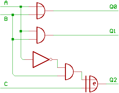

Enough of pointless ranting. Example:
 * pal16l8.c V1.0 (c) Dieter Mueller 08/2004
 * example: using a 64kB EPROM as programmable logic device.
 * 27512, gives 16 Input_Pins and 8 Output_Pins.
 * Note: unlike with PALs/GALS, the number/complexity of
 * product_terms/equations is only limited by the Pin count
 * of the EPROM... and the abilities of your compiler.
 * Not much memory used, generating 1MB files for 27080
 * should be possible under DOS.
#include <stdio.h>
#include <stdlib.h>
int main(void);
char do_rom(long addr);
int main(void)
  FILE *outstream;
  long i;
  outstream=fopen("pal16l8.bin","wb");
  if(outstream==NULL)
    printf("\nFile open error.\n");
    return(-1);
  for(i=0; i<0x10000; i++) //try all possible input patterns, 64 kBytes
    fputc(do_rom(i),outstream); //write one EPROM Byte
  fclose(outstream);
  return(0);
char do_rom(long addr) //do one Byte
  char out;
  char a,b,c;
  char q0,q1,q2;
 //default = Zero.
  a=0; b=0; c=0; q0=0; q1=0; q2=0;
 //scan input_pins. //WARNING: casting HAS to be, avoiding funny results.
  if((long)addr & 0x01) a=-1;
  if((long)addr & 0x02) b=-1;
  if((long)addr & 0x04) c=-1;
 //equations. //WARNING: thou shalt not use ! to negate.
  q0=a|b;
  q1=a&b;
  q2=(~a&b)^c; //((NOT A) AND B) XOR C //last stage of a full adder
 //now to throw all the results together.
  out=0; //default = Zero.
  if(q0) out|=0x01;
  if(q1) out|=0x02;
  if(q2) out|=0x04;
 //done.
  return(out);
