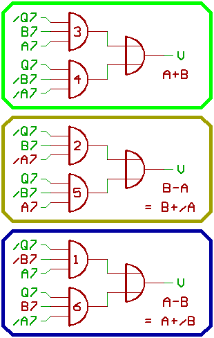

Problem is, that with ALU chips like the 74181, we don't have access to B'.
So we have to build our own B'.
For A+B, we could use the previous example.
For B-A, we have to invert A7.
For A-B, we have to invert B7.
I'm aware, that using colours in an article could look like a sign of incompetence.
But it's only to mark/emphasize the three different modes of operation.
Well, we would need six 4_Input_ANDs, one 6_Input_OR, and three inverters.
Could be done with 3*7420, 1*7430, and 0.5*7404.

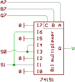

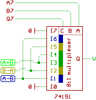

Fortunately, the 74151 features a nice AND/OR_combination,
that could be used to solve our problem.
We have three enable_lines, called A+B, B-A, A-B in that example,
only one of them could be active at a time.
You sure mentioned the numbers in the AND gates.
Please compare them to the 74151_Inputs in this schematic:
Now for the 74181.
There is no B-A.
Signals at the 74181 control lines (A,B high_active):
A+B: S3..0 = 1001
A-B: S3..0 = 0110
So we take S0 for indicating A+B, and S1 for indicating A-B.
