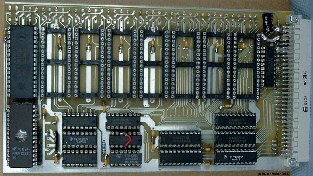

Wanted to know, if it's possible to build a binary compatible CPU
with the things I had in the drawer:
74LS parts, 27C512 EPROMs and a fast static RAM from an
old 80386 motherboard.
Now here the results.
Note, that the Bus timing is different from the 6502.

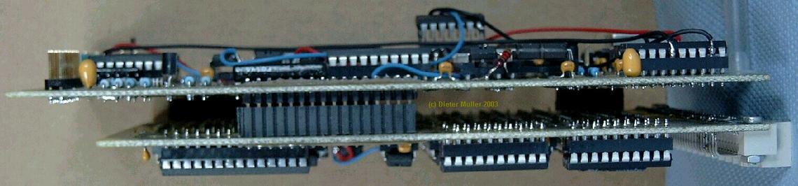

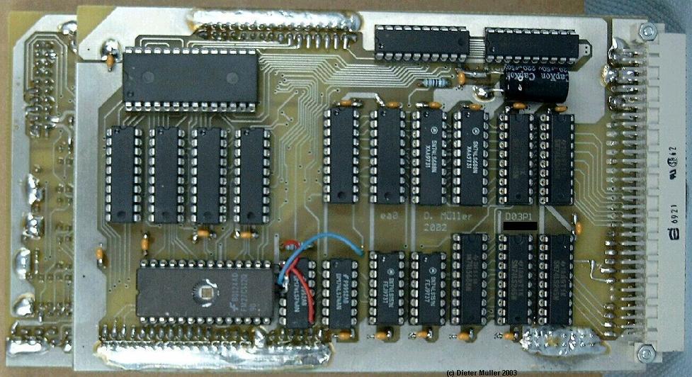

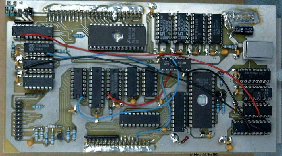

The CPU:
File Description
cpu.txt short description of the CPU
system.jpg big picture of the Computer

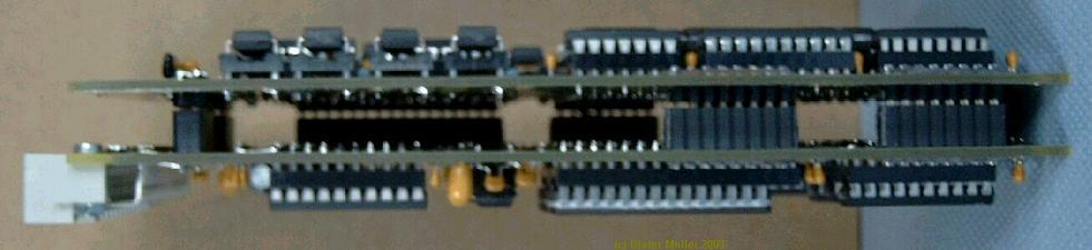

cpu.jpg CPU from the side
cpu_1.jpg CPU, PCB 1
cpu_2.jpg CPU, PCB 2
m02_3.zip Eagle3.55 schematics, layouts, SourceCode.

mem.jpg Speicher // Memory

[2016: Edit:                                                       ]
[ Might be possible to give M02 a more 6502 compatible bus timing. ]
[ This requires sampling A15..0 with 74573 transparent latches,    ]
[ and using a different microcode.                                 ]
[ Downside is, that the ALU would have to run 4 times faster       ]
[ than the bus (4 MHz for a 1 MHz 6502 that is),                   ]
[ but the M02 ALU wasn't able to go faster than 3 MHz.             ]
[...and that's what had triggered my interest in ALU design.       ]
[2016: Edit: some of the 65816 instructions probably have bugs...  ]
