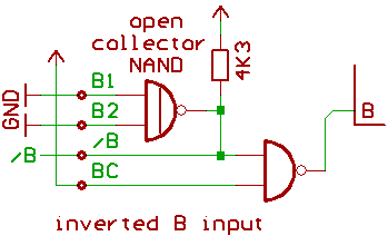

Depending on how we connect those funny NAND
gates at the A,B inputs, it is possible to configurate
the adder inputs to be high_ or low_active.
(inverted or non_inverted, that is).
There is a reason for all this, but we are discussing
that later. Now for the two different input configurations:
(Same thing for the A input.)
The first NAND (fed from B1, B2) is an open collector
type (like 7401), and the Signetics datasheet mentions
that the pullup resistor at the NAND output is 4.3 kOhm.
