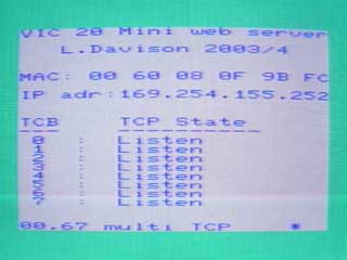

Source and binaryThe biggest change is to the TCP code. This has been modified to send RST packets, should they be needed, and now behaves more like the specification in RFC 793. It has also been changed to support multiple simutaneous connections and in this case up to eight simultaneous connections are supported, enough to serve two http clients with no noticeable loss in performance. RAM permitting, sixty four connections should be possible with only minimal code changes.

The low level code that handles the network interface card has not changed, neither has the ROM filesystem or the web pages held in it and there have only been cosmetic changes to the display code to show the status of the extra TCP connections. In all there are just over 530 bytes left in the 8KB ROM area that holds the data and code.
