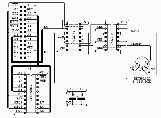

The connector on the top left of the diagram is from my own 6502 boards (see sbc project) and is as it is for two reasons. It's easy to wire on a stripboard layout and I have a lot of 26 way ribbon, headers and plugs. All the signals are directly from the 6502 except /SEL0 and /SEL1 which are used to select the block $F1xx with /SEL0=1 and /SEL1=0.

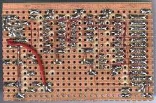

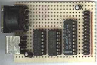

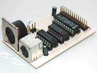

The 5 pin DIN socket is shown looking at the holes of the socket. On the finished board I also fitted a PS2 style socket, either one works but the DIN type is easier to mount on stripboard.
The two capacitors are low ESR electrolytics and are placed near the GAL and near the keyboard socket. If you don't have this type to hand you can use standard electrolytics with some low value ceramic capacitor, say 0.1uF, in parallel.
The GAL16V8A is used purely to generate the read and write strobes. Each is a negative going pulse coincident with phase 2. The interface uses just one byte in the address range. For anyone interested the equations for this chip are in atkey_01.pld and can be compiled with WinCUPL. The fuse file, atkey_01.jed and the compiler listing atkey_01.txt are also included.
The 74LS74 is used to latch the two lowest bits of the data bus during write access to the interface. The reset line is connected so that both of these outputs are cleared at start-up (this disables the keyboard until required).
The outputs from the latches are used to drive the enable pins on two of the four buffers from the 74LS125, these are then used to drive the data and clock lines of the keyboard. The buffers have their inputs tied low so behave like open collector outputs when used like this.
The other two buffers are used to drive the data bus during read access. Note that the keyboard supplies the pull-up for both the data and clock lines so with no keyboard connected you may read zero when you expect a one.

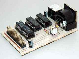

With the addition of two 4k7 resistors this interface would be ideal for use as an i2c bus master, if you look at the finished board photos you can see these resistors and a pair of jumpers to select them. It turns out that another small change needs to be made. The result can be seen in my I2C project page.
