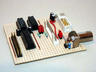

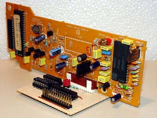

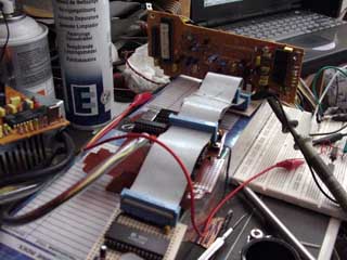

The connector on the top left of the diagram is from my own 6502 boards (see sbc project) and is as it is for two reasons. It's easy to wire on a stripboard layout and I have a lot of 26 way ribbon, headers and plugs. All the signals are directly from the 6502 except /SEL0 and /SEL1 which are used to select the block $F1xx with /SEL0 = 1 and /SEL1 = 0.
There is no socket shown for the I2C bus, this is up to the user.
The two capacitors are low ESR electrolytics and are placed near the GAL and between the two chips. If you don't have this type to hand you can use standard electrolytics with some low value ceramic capacitor, say 0.1uF, in parallel.
The GAL16V8A is used purely to generate the read and write strobes. Each is a negative going pulse coincident with phase 2. The interface uses just one byte in the address range. For anyone interested the equations for this chip are in i2c_01.pld and can be compiled with WinCUPL. The fuse file, i2c_01.jed and the compiler list file i2c_01.txt are also included.
The 74LS74 is used to latch the two lowest bits of the data bus during write access to the interface. The reset line is connected so that both of these outputs are set at startup (this disables the I2C bus until required). This is very similar to my AT keyboard with the exeption that reset sets the opposite state.
The outputs from the latches are used to drive the enable pins on two of the four buffers from the 74LS125, these are then used to drive the data and clock lines of the I2C bus. The buffers have their inputs tied low so behave like open collector outputs when used like this.
The other two buffers are used to drive the data bus during read access.
