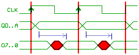

But there is one more problem:
Note the red marked areas.
The counter changes the values at it's outputs QA..QC shortly after every
rising edge on CLK.
But it takes the EPROM some time to stabilize the values at it's outputs
at O0..7.
With 74LS163 and a 70ns EPROM, it may take up to 100 ns after the rising
edge on CLK, until O0..7 are valid.
We only controlled LEDs, and the 74163 only reacts to the signal at !LD
at the rising edge of CLK, when O7 was stable.
We didn't mind, because timing/speed/propagation_delay was not important
until now.
But edge triggered TTL logic could become very confused from such a signal.

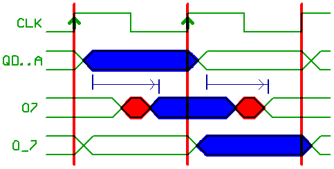

A good trick is, to take a 74374 latch, and to sample O0..O7 with the rising
edge on CLK, when they are stable.
The 74374 outputs O_0..O_7 will be clean/stable...
but are valid one CLK cycle later.
Neverthless, we now can use Q_7 to clock another 74374,
that latches the two Bits from our switches when the counter flips to zero,
and updates A4,A5 for "program start".
Instead of that, we could have used the 74377 synchronous latch, that features
a clock_enable (what could be directly connected to O7).
Another solution is to use/abuse a 74163 to work as a synchronous latch
(by disabling counting, and connecting !LD to the !CLR input of our counter
that feeds A0..3).
