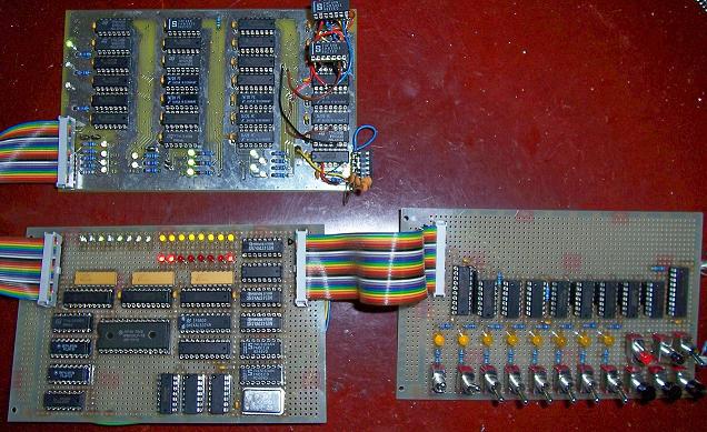

An alternative was the MC14500. It was able to control
the counter, to read inputs, and to write outputs.
The MC14500 is an odd/unique design, that can't be categorized easy.
It shows program flow control like a simple RISC (skip next Opcode
if result is zero, JMP, JSR, RTS), combined wit a one Bit Logic Unit
(no arithmetic at all !)
Still undecided, if it's a processor or not.
4 Bit Opcode, 1 Bit Databus, Program memory and Data memory
are separated.
RR, or Result Register, was used as accumulator.
O_EN enabled/disabled write access to data memory.
I_EN was used to force a read value from data memory to Zero.
This way, it was easy to emulate flipflops, and to save
a few conditional jumps.
Opcodes: 0x0 Flag 0 // Emit pulse on FLAG_0 Pin 0x1 LD // RR = (D_IN & I_EN) 0x2 LDC // RR = !(D_IN & I_EN) 0x3 OR // RR = RR | (D_IN & I_EN) 0x4 ORC // RR = RR | !(D_IN & I_EN) 0x5 AND // RR = RR & (D_IN & I_EN) 0x6 ANDC // RR = RR & !(D_IN & I_EN) 0x7 XNOR // RR = RR ^ !(D_IN & I_EN) 0x8 STO // Write RR to data memory, if O_EN = 1 0x9 STOC // Write !RR to data memory, if O_EN = 1 0xa IEN // I_EN = RR 0xb OEN // O_EN = RR 0xc JMP // jump 0xd RTN // return from subroutine (ignore next opcode) 0xe SKZ // skip next opcode, if RR is Zero 0xf Flag F // Emit Pulse on Flag_F PinDecided to use Flag 0 as NOP, and Flag F as JSR.
LD 0 // RR = I_EN & DIN ORC 0 // RR = RR | !(I_EN & DIN) = 1 IEN // I_EN = RR
Tried to build something binary compatible with NAND gates.
It turned out to be not so useful at all, but it gave me a few
inspirations for ALU design and timing.
WARNING: the design had a few bugs.
Fixed them in layout and schematic, but didn't build
this version for verification.
Do not expect it to work at all.
Better go with GAL22V10 than with NANDs.
28 ICs: 14*7400, 6*7410 7*7420, 1*7430.
Decided to use low_active outputs, most of them not pulsed,
because the PC was done with syncronous counters.
Note, that this schematic/layout does not contain I/O,
program/data memory, program counter, or return stack.
It's only the "CPU".
