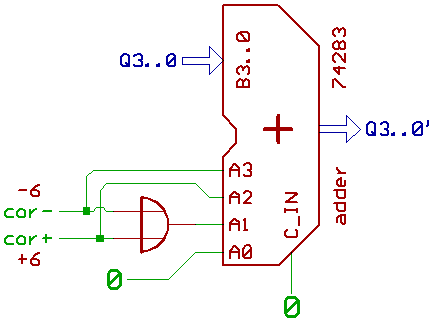

When using 74xx TTL, decimal correction could be done with a 74283 binary adder.
Adding 6 (binary 0110) is easy.
For 4 Bit, subtracting 6 would be the same as adding its two's complement
decimal 10 (binary 1010).

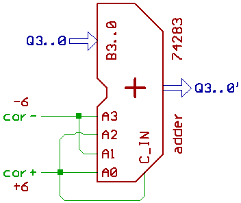

The OR gate could be removed/eliminated by using the carry input:
we're simply adding 5+1 instead of 6.

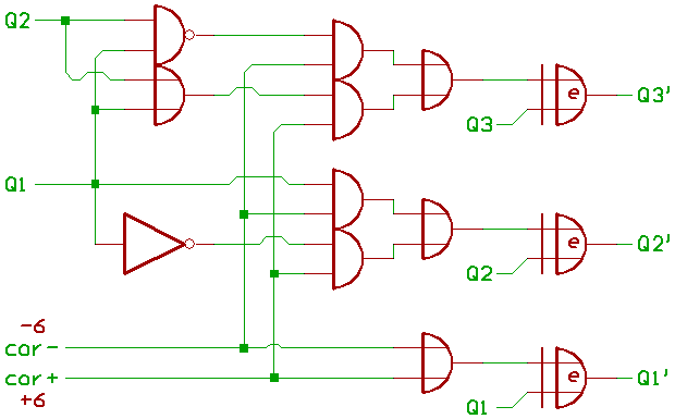

When using transistors or logic gates, it isn't necessary to rebuild a complete 74283.
We could build some half adders instead, and invert the Bits that have to be corrected:

Well.
X0 is always 0,
X1 is always 1,
X2 is equal to !Q1,
X3 is zero, when Q1=0 and Q2=0.

X0 is always 0,
X1 is always 1.
X2 is equal to Q1,
X3 is zero, when Q1=1 and Q2=1.
So Q0..3 XOR X0..3 gives us Q0..3', and that's all.
