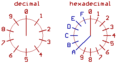

Left: decimal. 0..9, Base 10.
Right: 4 Bit hexadecimal. 0..F (decimal 0..15), Base 16.
When calculating decimal numbers in binary/hexadecimal,
the trick is to skip/avoid numbers between 10..15 (A..F),
and it is called decimal correction.
From the decimal point of view, we may call such numbers
illegal values, or invalid 4 Bit codes...
or, to make it sound more complicated: pseudo_tetrades.
When incrementing 9, the result would be 10 (hexadecimal A).
Adding 6 gives us 0, and a carry that increments the next higher digit.
So the result would be 10.
When decrementing 0, we would have 15 (hexadecimal F).
Subtracting 6 gives us 9 as a result.
