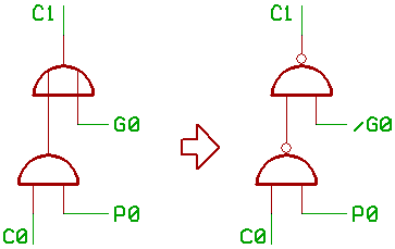

Fast ripple carry
Ripple carry is, basically, a slow thing.
P propagates the input_carry through.
G generates the output_carry.
Bad thing is, that we have a propagation delay
of two NAND gates per Bit.

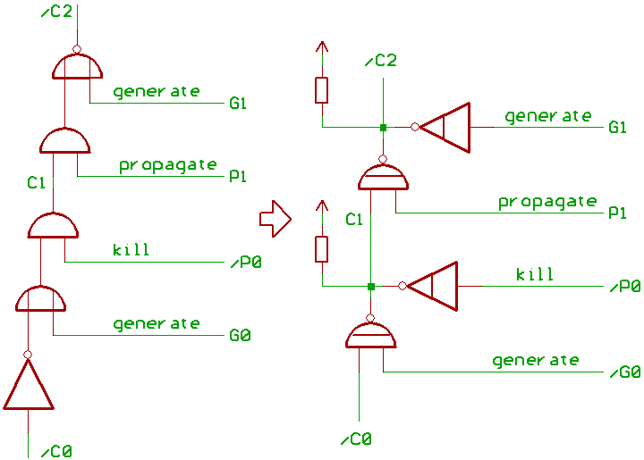

There is a trick, how to double the speed.
But it requires open_collector (or open_drain) NANDs,
and for the carry signal we have to change between
low_active / high_active after each Bit.
Now to describe, how it works.
If /C0 or G0 are active, there is a chance, that C1
could become active.
We know, if /P0 is 1 (inactive), C1 will not be active.
So we use /P0 as a "kill carry" signal.
For generating /C2 from C1, we already know what to do.
