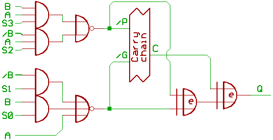

The 74181 ALU:
A marvel of logic design.
It also has a control line, called M, to select
arithmetic or logic operation mode.
In logic mode, the carry chain is disabled, and the
high_active carry_outputs are forced to 1.
(In all examples mentioned here: high_active A,B,F and
low_active carry at the 74181 I/O_pins)
Like with the 8260, this turns the XOR at the output into an inverter.
Now to discuss how it works in detail.
