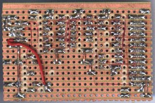

The circuit is built on stripboard. Layout is not critical, power is
linked using 0.8mm uninsulated copper (the centre from tv coax, or
similar, is ideal) and the logic is wired on the print side with self
fluxing 32swg enamel covered copper wire. The header and DIN socket were
re-cycled froma dead PC motherboard using a 750w hot air paint stripper.
The two capacitors are low ESR electrolytics and are placed near the GAL
and near the keyboard socket. If you don't have this type to hand you can
use standard electrolytics with some low value caramic capacitor, say
0.1uF, in parallel.
