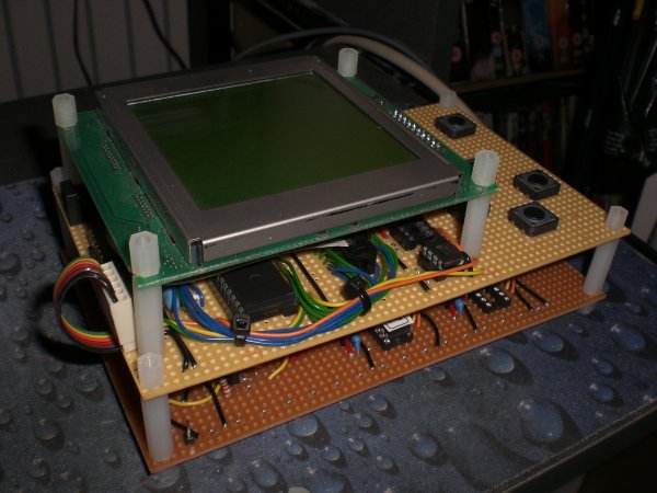

The picture below shows the current state of the prototype.
Hardware Design
Miranda comprises of two stacked veroboard cards with a 128x128 graphical LCD module on top. The topmost card is manages the display and all the communication while the lower one supports the slave engines.

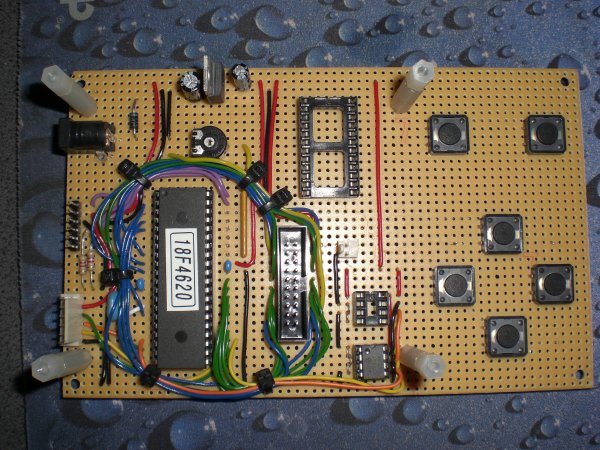

Master Card
The master card is uses a Microchip 18F4620 device. The buttons on the right side allow the user to select pieces and enter moves. The 20-pin ribbon connector in the middle provides the data and control connections to the GLCD. The smaller 2 pin connector next to it goes to the GCLD's back light.
In the top left corner is a simple 5V regulator designed to take 9-12V DC via the power socket.
The two 8-pin DIP sockets (bottom centre) are for I2C flash memory chips. These will be used to hold a database of opening moves.
The lower connector on the left hand side is used to connect the master and slave cards. The 6 pin header above it is for a Microchip PICKit2 programmer.
The empty socket (top middle) is for an FTDI UM232 USB/Serial adapter to allow Miranda to be connected to a PC for communication and power. This will be connected to the master processor's USART pins eventually

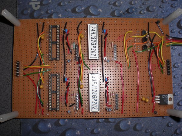

Slave Card
The slave card is designed to hold up to four dsPIC processors. The prototype only has two fitted at present. Each processor socket has its own 6-pin programming header to its right. The connectors on the left and right sides allow me to connect a protocol analyser to the communication bus at either 5V (right) or 3V3 (left) levels.
As these dsPIC devices operate at 3V3 there is another power regulation circuit in the bottom right corner and three MOSFETS in the top right are used to perform bidirectional level conversion (3V3 <-> 5V) on the communication signal lines.

The slave card has a problem with its level converter circuit. I used the wrong MOSFETs and the signals are not properly adjusted. Hopefully I now have the right ones but I haven't have the time to install and test them.
Update:
It now seems I don't have to do the level conversion on the I2C pins - its was a mistake in the datasheet. If this is the case then the MOSFETs can be removed entirely but I will have to rewire one of the connections used to signal back to the master as its currently connected to a 3V3 only pin.
