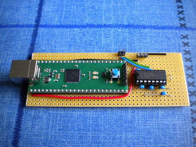

My main development platform at the moment is a DEV-PIC24FJ256GB206 module supplied by Robot-Electronics. The PIC24FJ256GB206 contains 66K of Extended Data Space (EDS) which can be mapped in 32K chunks into the data address space however it executes relatively slowly.

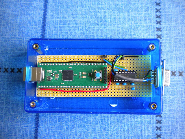

The enclosure has a hole for a DB9 serial connector which connects to the board. I use a USB Serial adapter to access the device from my PC. Eventually it will have a USB CDC driver in firmware to allow it to be connected directly to a USB socket.
I've only broken out two pins from the module for serial interfacing. I want to add an SPI interface to an SD card to give the emulated 65C02 a virtual hard drive.

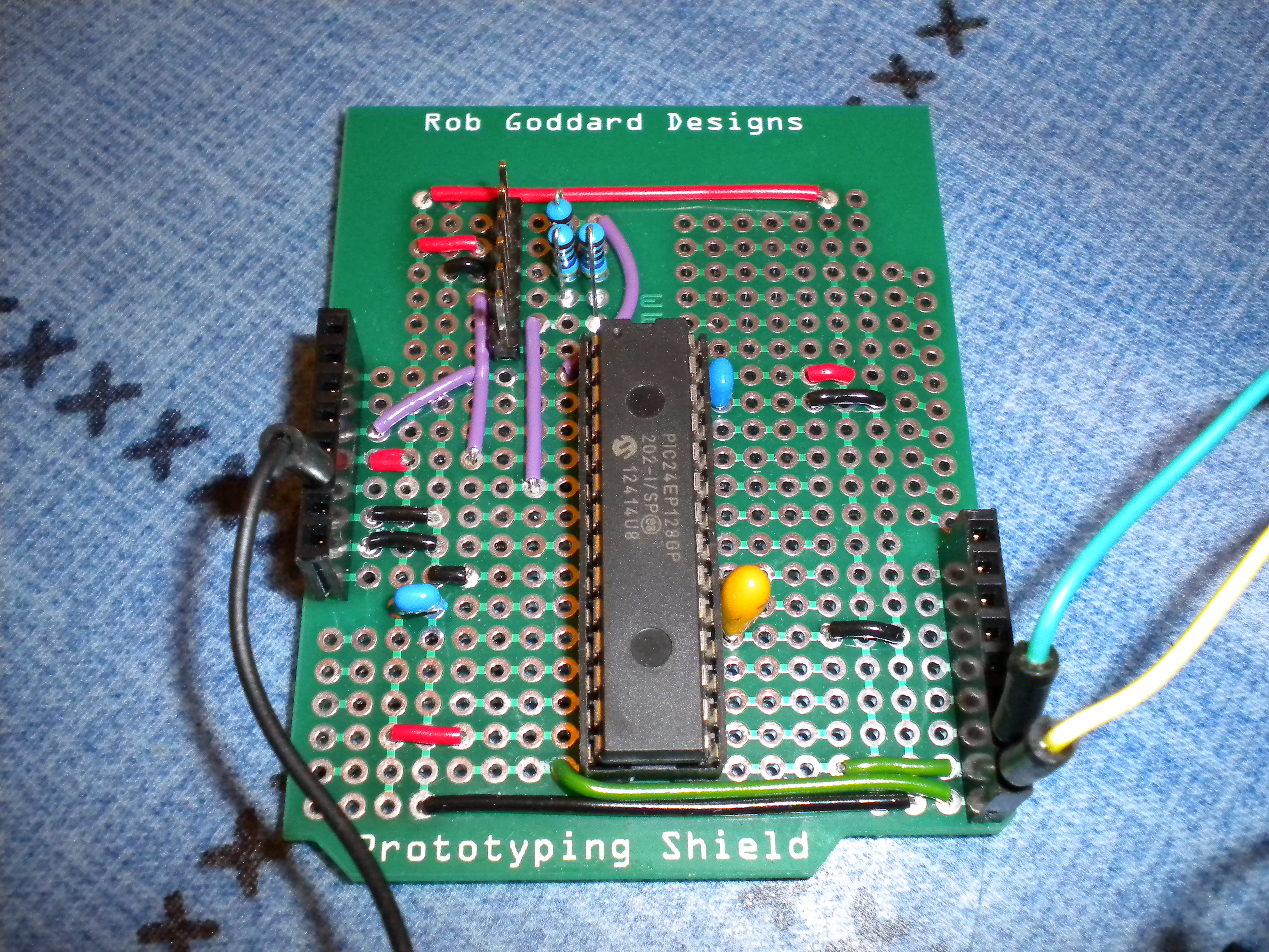

The second developement board I've build uses an Arduino style prototype board and uses a 28 SPDIP device like a 24EP128GP202
