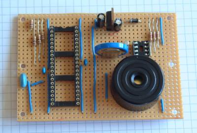

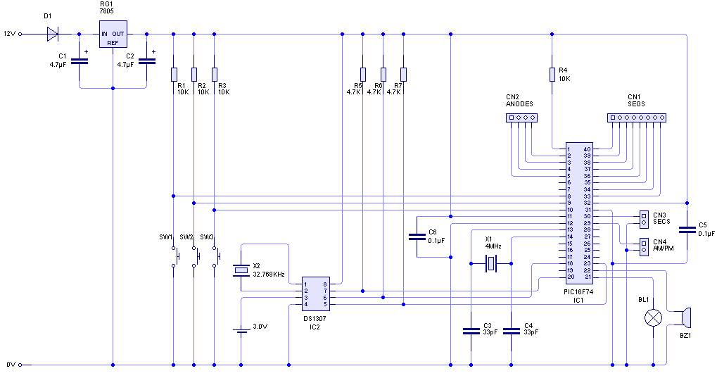

The larger of the two circuit boards holds the 5V power regulator, the display processor (a PIC 16F74), the real time clock (Dallas DS1307), 3V backup battery and buzzer. Click here to see a copy of the schematic for the base board in a popup window.

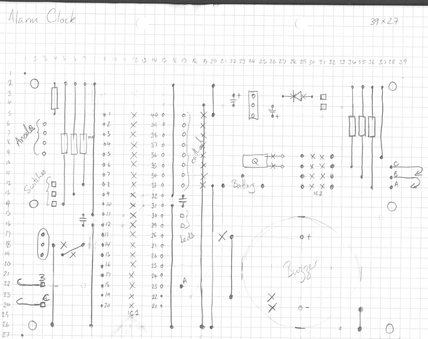

The PIC board looked like this before fitting the ICs and LED/switch wire connections. It is also missing the 1Hz signal, I2C clock and I2C data connections between the PIC and RTC chips. ---I used a 4MHz resonator with built in load capacitors instead of the crystal and separate capacitors shown on the schematic. Also I added one more link wire after taking this photo to connect GND to -ve terminal of the backup battery. (The copper tracks run left-to-right on this board with cuts between the IC pins and in a couple of other strategic places - Click here to see my strip board layout sketch).
The PIC microcontroller is programmed to read the real-time clock using I2C serial communication several times a second and update the display. It does no time keeping itself. Even the pulsing central pair of LEDs are driven by the real time clock (by means of a 1Hz output signal) and which is read by the PIC.
The PIC performs two other functions; it compares the time against the alarm settings to determine when it should go off and also handles time, date and alarm setting. The 16F74 has no EEPROM of its own so all the settings are stored in the DS1307 and read at power-on-reset. I was planning to mount connectors on the board for all the switch and display wires but in the end there wasn't enough room so I soldered the wires directly
I ordered a 16F74 microcontroller from Farnell because it had more than enough I/O pins and supported I2C on chip. After I received the chip and read the small print in the data sheet I discovered that the SSP module was only really suitable for an I2C slave. What I really needed was a MSSP module. So my code disables the SSP module and generates the I2C master clock and data signals (on the RC3/SCL and RC4/SDA pins) using a 'bit-banged' approach.

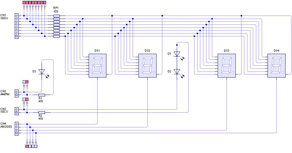

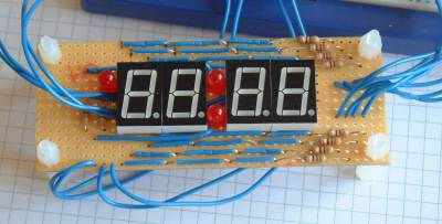

A smaller circuit board holds all the display LEDs and sits above the base board on plastic spacers. Click here to see a copy of the schematic for the display in a popup window.
The numeric display is uses four red common anode seven segment displays I purchased on e-Bay. Each segment anode has its own 'select line' (RA0-RA3) and shares the eight cathode connections (RB0-Rb7) to control the segments. An interrupt routine in the PIC updates each segment in turn for approximately 1/100 of a second and updates the state of the AM/PM and pulsing LEDs. (The vero-board used for this card has copper tracks running top-to-bottom with a central gap running horizontally across the whole board).
