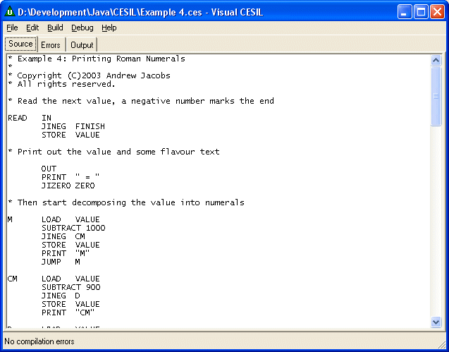

Visual CESIL
OK, now its your chance to try this wonderful language for yourself. (Is that good news?) Visual CESIL was originally written as an exercise in Java programming (in Visual J++) but Microsoft dropped support for this environment so I've ported the code to C# and .Net 2.0.
To get started with Visual CESIL you will need one of the following zip files which contains the IDE packaged as a standalone Windows .EXE and a few examples. Versions 1.1 and 1.2 need the Microsoft Java JVM to operate and may not work on newly installed machines. I've also made a command line version of the compiler and runtime which should work on any Java platform.
