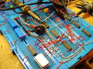

So far I have two RGB linear CCD arrays from scrapped flatbed scanners, one 2700 pixel (Sony ILX524) and one 5300 pixel (Sony ILX535), and a hastily thrown together clock circuit to test them (picture right).
This will not be part of the final circuit, in that all the clock waveforms will be generated by a microprocessor, but was built just to try out the sensors and see if I could get them to work.

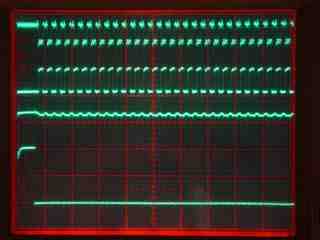

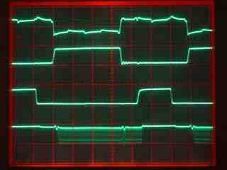

So far, using the 2700 pixel sensor, I've managed to replicate the waveforms from the datasheet and got active video out from each of the Red, Green and Blue lines.

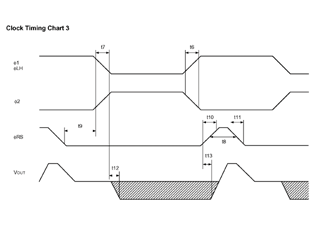

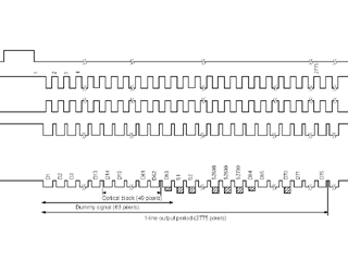

The above traces can be compared with the idealised waveforms from the datasheet. (The noise on the upper trace in both images is caused by pick up on one of my cheap 'scope probes.)
