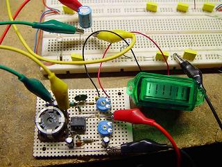

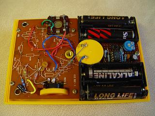

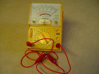

Construction is not critical and, as some components like the transformer core were selected from what was available at the time, a printed circuit board is not really practical. The first two prototypes were built entirely on stripboard, the last one partly on stripboard and partly on the remains of the donor multimeter circuit board.
The 100K pot in the circuit is any subminature type but the adjustable meter series resistor should be easy to adjust by hand as its setting will need to be varied to set the meter zero which will depend on the leads used with the meter and the age of the batteries. In the old multimeter used for the last version there was such a pot already present and this, along with a fixed resistor, was used as the meter series resistor.

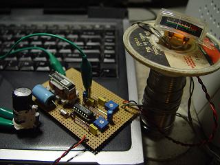

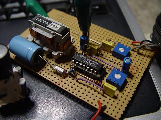

The transformer can be wound on any small ferrite core that has room for all the 400 primary turns and the 20 secondary turns. The actual core used is not critical, almost any ferrite core will do, and the small feedback tranformers in computer power supplies or the output transformer from a cold cathode fluorescent lamp inverter would be ideal. The first prototype and this version used the core from an audio filter inductor while the second prototype, seen here, used a transformer that already had two ten turn windings that were used in series and a winding with many hundreds of turns that was unwound until only about four hundred turns remained.
No special care needs to be taken winding the transformer, I wound the secodary first and then wound the primary directly over it using 30 SWG, 28 AWG, coated copper wire for both the primary and secondary.

The meter is also not critical, Any meter that is sensetive enough, i.e. 150uA or better, can be used. The first prototype used a tuning meter from an old FM receiver, the second, shown here, used the signal strength meter from a CB radio.
The series resistor to the meter should be chosen to suit the meter, the better the sensetivity the higher value it should be. In the first prototype this resistor was only 10K ohms but for the 50uA multimeter meter the original 39K ohms adjustable resistor was reused along with a 27K fixed resistor to give a usable range.

Once the meter is set up and working you may wish to make a calibrated scale for it. The easy way to do this is to use a series of good accuracy, say 1%, low ohm resistors and testing each in turn mark its value on the meter scale. You can then photograph or scan this scale and use it as a template to print out a new scale for your meter. In the case of this meter the original ohms scale, although reading ten times the actual value, is close enough to be used at is.

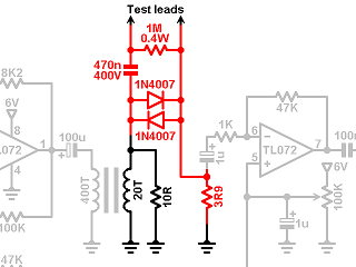

400V input protection
Sooner or later I'm sure I'll try to measure the ESR of a capacitor that is charged or even still powered. This modification should go some way to protecting the meter from being damaged by this kind of mistake.
The added components, shown in red, are a 400V 470nF unpolarised capacitor to block any DC voltage and two back to back 1N4007 diodes to divert any charging current for this capacitor away from the transformer and associated components. Finally a 1M ohm 0.4W resistor is added across the test leads to dissipate any charge on the 400V 470nF capacitor.
In normal use the two back to back 1N4007 diodes never conduct so have no effect on any measurements made and the 1M ohm resistor likewise is far too large to matter. The 400V 470nF capacitor does change the signal source impedance a little and to compensate for this a 3.9 ohm input resistor, also shown in red, replaces the original 2.2 ohm resistor to keep the scale calibrated.
Any of the 1N400x range of diodes could be used, I used 1N4007s because that's what was to hand at the time. The maximum reverse voltage they ever see will only be the forward voltage of the other diode, so there is no need for high reverse voltage parts.
The added components were fitted onto the remains of the original multimeter circuit board. The 1M ohm discharge resistor can just be seen underneath the 400V 470nF capacitor and alongside those are the two back to back 1N4007 diodes. All the added components fit easily within the donor multimeter case.
