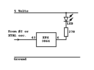

This circuit, being the first 8 Bit Baby project, is made deliberately simple, mostly so that there is less to go wrong but also because I'm lazy and I wanted something to show for just a little work. Apart from the 8 Bit Baby, the programming lead and software all that's needed is an LED, a resistor and an 8 bit computer to plug it into or, lacking that, an XTAL oscillator and a socket.
The circuit.
Yes that's it. Even I can't mess that up1. The circuit works by taking the clock input, which is either Ø2 from the host CPU or one to two MHz from an XTAL oscillator, and divides it by 1048576 to give a roughly one Hz flash rate.

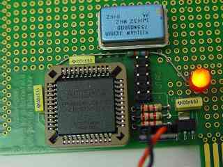

As I didn't want to make room on the bench for a Vic 20 or C64 I decided to go with the XTAL oscillator. For this a socket was mounted on the 8 Bit Baby and wired to the +5v, ground and the EPM3064. The LED was fitted and a short bridge soldered between the anode and the +5v and finally the 270 ohm resistor was fitted with one end soldered to the LED cathode and the other to pin 6 on the EPM3064.
The design.
The design uses three cascaded 8 bit synchronous counters to make a 20 bit divider. The first counter is enabled continuously and the carry out from that counter is high for one count in every 256 counts. This carry signal is inverted and used to enable the second counter so that it only counts once in every 256 cycles. The carry out from this counter is again inverted and used to enable the third counter, this counter only counts once in every 65536 cycles and the fourth output bit from this counter, that changes state every 524288 cycles, is used to drive the LED output pin giving an overall ratio of 1:1048576

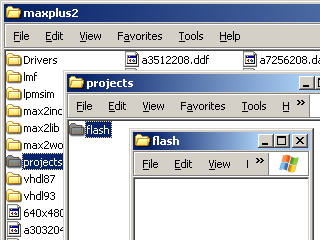

Create a projects folder and in that a folder for the project

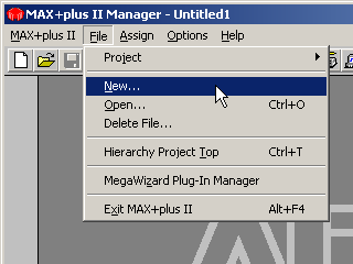

Now start Max+Plus II and select File, New...
Select the radio button for Graphic Editor file and click OK

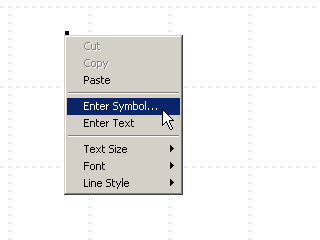

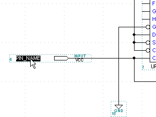

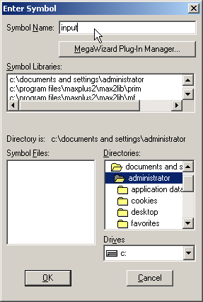

Either double click, or right click and select Enter Symbol..., to bring up the new symbol dialog box.
In the Symbol Name field type input and hit Enter.

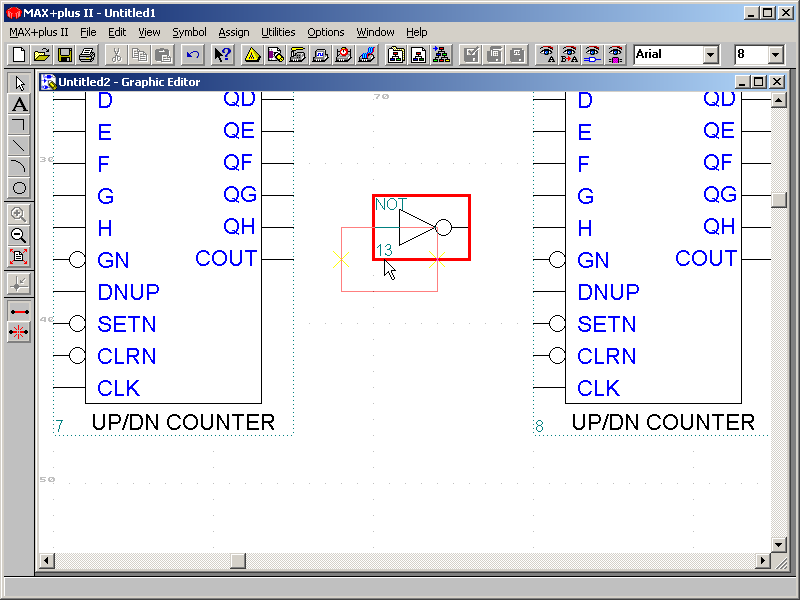

Do this for the other symbols, three of 8count and vcc, two of not, one gnd and an output.
Symbols can be moved using the left mouse button to click and drag them. Click and drag between pins to connect them.

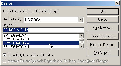

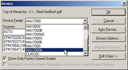

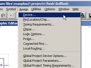

Now the project is set a device can be assigned
For the 8 Bit Baby it's the MAX3000A family ..
.. and EPM3064ALC44 for the device.

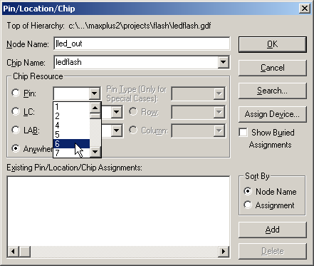

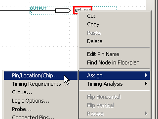

Pin names can be changed by double clicking on them and typing the new name
To assign a pin number right click on a pin symbol ..
.. and select the number for the pin. Pin 6 for the output in this case.

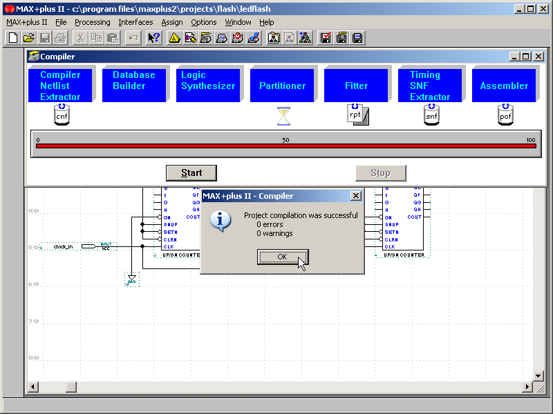

From the File menu select Project -> Save & Compile and you should get this.

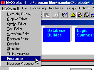

Before you try to program the device make sure you have the ByteBlaster MV cable connected and the 8 Bit Baby powered, either in the target system or from an external power supply.

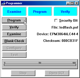

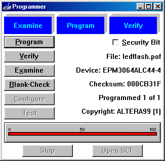

Now the device can be programmed
If it's connected you'll see this, so just click Program
After a second or so you should get one of these ..
.. and a window like this.
That's it. If everything went to plan, the LED was already connected and it was in the target system or an XTAL oscillator was connected, then the LED should start flashing as soon as the programming is complete. It's Alive!
