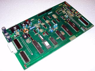

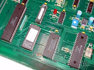

68008 Dartboard control pcb. By Lee Davison. |
The dartboard control pcb is a 68008 based single board computer. As it comes it has the following features.Documents.68008 running at 8MHz 64k bytes of EPROM 8k bytes of (battery backed) RAM 68681 DUART providing two independant RS232 channels Two 68230 Parallel Interface/Timers 8 bit A to D and D to A Three 75518 VFD drivers providing 96 VFD segment/grid drivers UNL2003 high current/voltage driver TBA820M audio amplifier for tone output Software I2C interface Onboard rectifiers and regulators requiring only a 12v AC input
