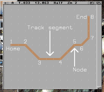

Each track can be thought of of a number of points, or nodes, joined by straight lines or segments. It is the lines that make up the track but the nodes that fix the position, layer and width of the track.The start of the track is the home node. This defines the point that all shift, repeat or flip functions work from. Next are the intermediate nodes and finally the end node. It is important to understand this as it is the nodes that are moved and changed to change the appearance of the segments when editing a track.

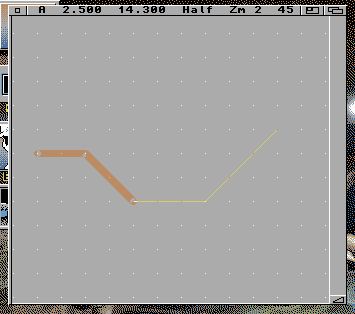

You will now be in track mode. If rubberbanding is on then one or two lines will be displayed to show you where the next segment(s) of track will lie.
To continue the track just move the pointer to where you want the track to go and click the left mouse button or press [RETURN].
To exit track mode, and end the track, either click the right mouse button or press escape. Before you do that though you may like to try some of the other track commands available.
Track navigation.Other track functions.You do not need to be at the end of a track to edit it. It is possible to move about the entire length of any track using the following commands.Home.Makes the home node (node 1) the current node. Select either via menu Track Home or by hotkey [h].Back.Makes the preceding node the current node. Select either via menu Track Back or by hotkey [b].Next.Makes the succeding node the current node. Select either via menu Track Next or by hotkey [n].End.Makes the last node the current node. Select either via menu Track, End or by hotkey [e].
