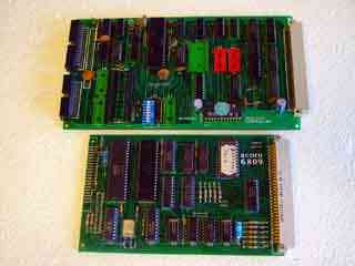

While it looks somewhat like a Eurocard card, they both use the same 64 way connector, and it is similar in size the Microtan card is 43mm deeper and 15mm taller than a standard 160mm x 100mm Eurocard.

Microtan 65 with the smaller Eurocard Acorn 6809 beside it.

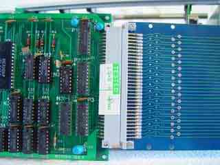

Microtan TANRAM on a Eurocard extender, note the height difference.

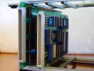

The CPU, TANEX and graphics cards all have differently located connectors.
