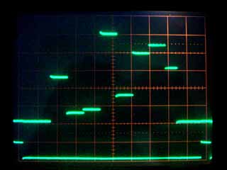

In this example the SuprDupr is used as an analog multiplexer to display eight analog inputs as a 'bargraph' type display on a 'scope.The SuprDupr also generates a trigger pulse to synchronise the 'scope on the second analog output.
The upper trace is the multiplex out, the lower trace is the trigger pulse.
10 REM 8 channel analog multiplex 20 REM displays 8 analog inputs as 30 REM a 'bargraph' type display on 40 REM a two channel 'scope. 50 REM 60 REM Analog out 1 is the trigger signal 70 REM Analog out 2 is the multiplex 80 REM 100 DO : REM start of main loop 110 D2A1 255 : REM trigger pulse high 120 D2A1 0 : REM trigger pulse low 130 FOR ch=0 TO 7 : REM for each channel 140 D2A2 A2D(ch) : REM read port & out to scope 150 NEXT ch 160 D2A2 0 : REM set bar output level 170 LOOP
