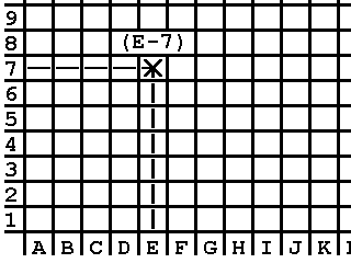

    At this point, Petspeed makes the protection check. On the inside cover of this manual or on a separate sheet, or by clicking on the image on the left, will be found a matrix of coloured squares. Each square can be identified by means of a simple grid reference. For example to find square E-7, identify column E (marked along the bottom of the matrix) and row 7 (marked along the left hand edge). Square E-7 is where column E and row 7 meet. (see fig 1).
    The protection check is very simple; all you have to do is correctly identify three squares and enter their colours. Petspeed will give instructions as follows:
    WHAT COLOUR IS SQUARE X-XX ?
    where X-XX is a grid reference. When you have found the square, enter one of the letters W,Y,G or R depending upon whether the square is white, yellow, green or red. When you have correctly answered three such questions the protection check is complete.
