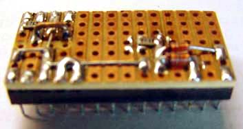

Here's a simple circuit, built from bits in the junk box, that has saved many hours of head scratching when that just finished new 6502 circuit failed to work first time.
What does it do? Well nothing much, in fact a lot of nothing much's as it pulls the data lines on a 6502 to the NOP ($EA) opcode.
The circuit is built on a small piece of stripboard that has been soldered onto a 28 pin turned pin I.C. socket. This is the only important part of the project, use decent (i.e. stiff and thin) pins. Don't be tempted to use IDC header type pins, as they are too thick and will ruin the socket you push them into. If you have them use I.C. header pins, I didn't but a turned pin socket, used as a header, is just as good.

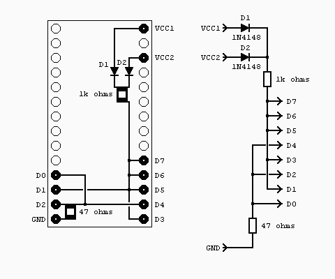

The two diodes, I used 1N4148s but any small signal or shottky diode will do, are to allow the use of this generator in either 24 or 28 pin sockets. If you are only ever going to use one type then the diodes can be omitted and the 1k resistor tied directly to the +5v pin.
6502 NOP generator circuit.
The 1k resistor is used to pull up the five data lines that need to be at logic 1, I could have used five 4k7 resistors but I'm lazy. This works just as well.
The 47R resistor in the pull down path is just there to limit any possible ground path fault current to around 100mA, while still providing a firm logic 0 to the data bus. Any value from 33 to 100 ohms should do just as well.

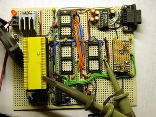

So your latest 6502 whizzymajig is DOA. Even a short test program doesn't seem to work. So how will this help?
Replacing the system ROM with the NOP board, and with the help of a logic probe, allows you to verify that you at least got all the data lines connected and in the right order. While you're there you can also check the data lines to the RAM, I/O and any other chips that connect to the data bus.
So the data lines are all connected ok, now on to dynamic testing. With just the CPU and the NOP gen the CPU should do a read cycle at all 65536 addresses in sequence. If you have a scope with at least an external trigger, or better yet with two channels, you can trigger from some known signal and see if other signals are behaving as expected.
